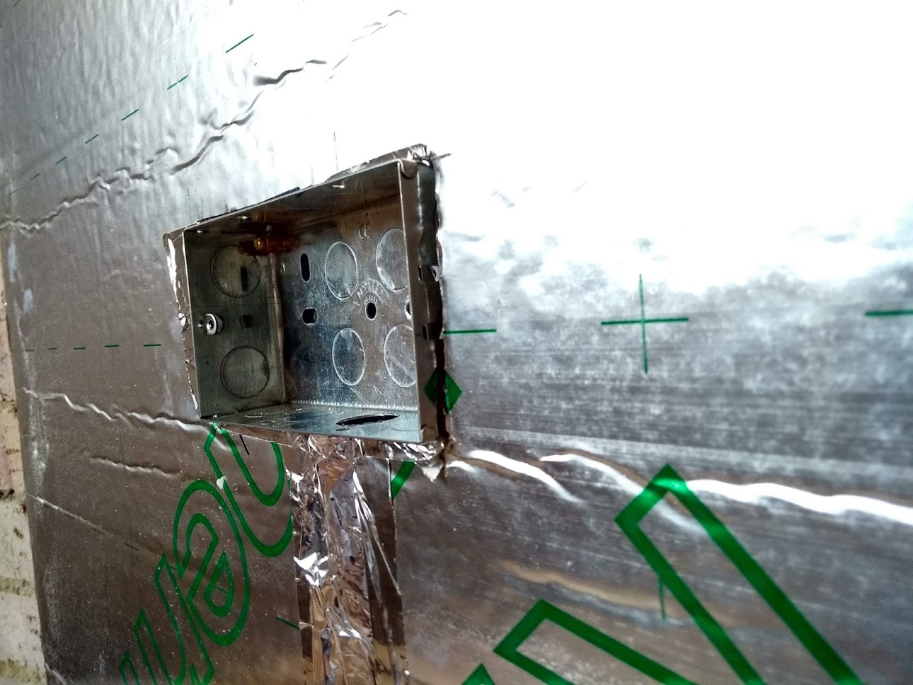

This is what I did too. My electric cables are under the suspended wooden floor and go up to sockets, so shorter run, and light switches were all on inside walls. But only last night I mad a little channel for some cable in the bathroom install (maybe I will widen them). Probably a pic of what I did before somewhere too ...
not the best photo, but I guess not so easy in the bonded insulated plasterboard?

The photo Jonbey used is exactly the same as how I did it.
Although I sometimes used dry liner boxes.
I also put the the boxes in after putting up plasterboard.
So I put in the cables , marked on the floor where they where and how high. Then I put up the plasterboard and cut hole in the plasterboard (very carefully as there are now cables behind) for the metal or dry lining box. Cut bigger hole in insulation to take box. Put box into hole pulling cables into box (remembering to rubber O ring into metal box to stop cable being damaged).
