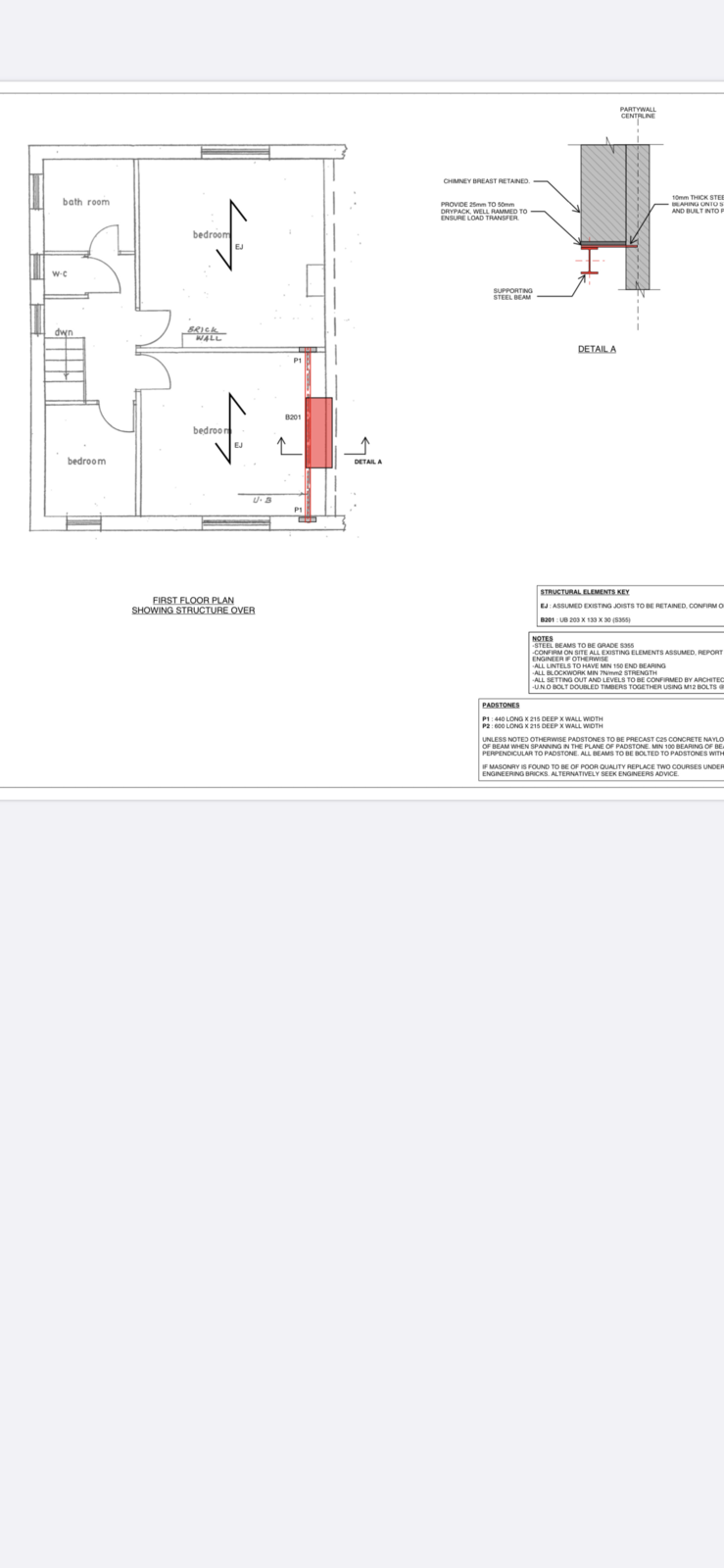

I am having a chimney removed on the first floor - I have structural engineer calculations for a UB but he has specified steel plates and padstones.
I have tried to get in touch with him to explain it further but so far no luck.
My builder is not familiar with the steel plate - I have attached a copy of the engineer report , can you please help me understand it - where does the steel plate go?
Do I order a beam with a steel plate attached to it ?
Thank you

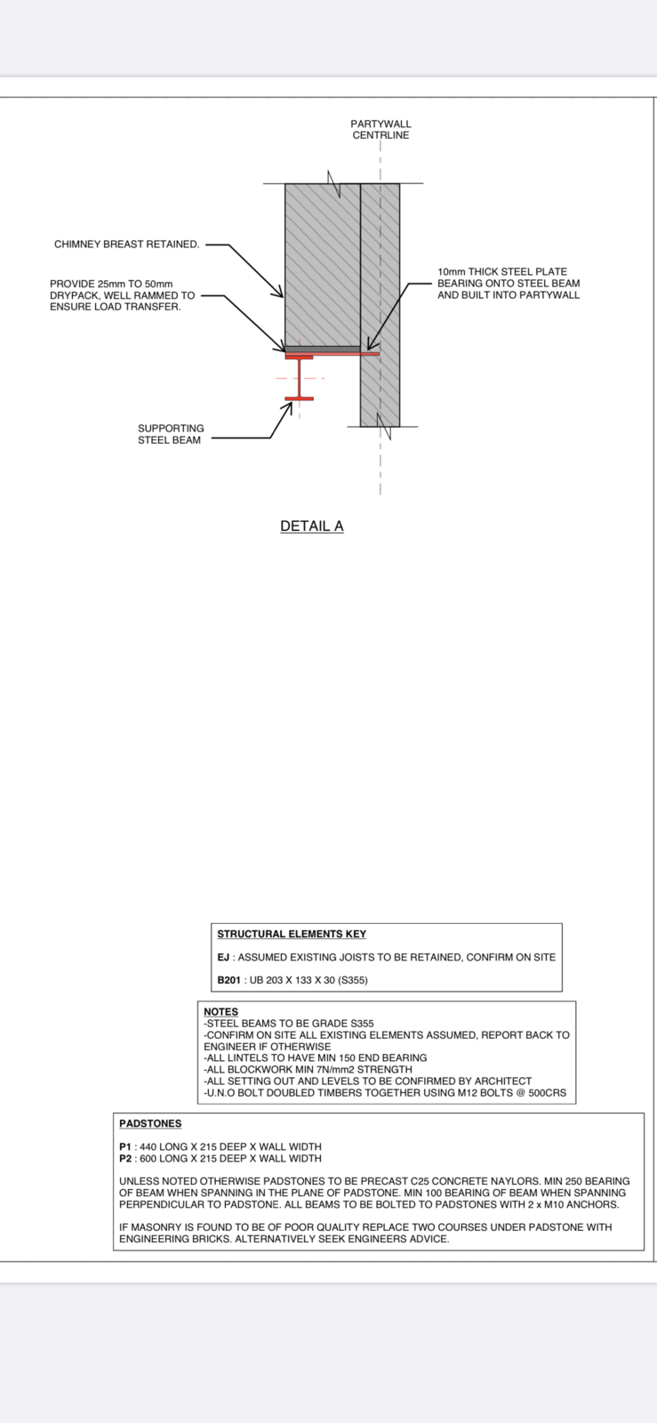

The steel plate gathers up all the masonry that the beam misses. It is let into the party wall bed joint and rests on the new beam. I assume it travels the length of the chimney breast.
Is there another page to that report- you've got the section but no plan.
You say first floor- so you're leaving the chimney where it goes into the roofspace yes?
The steel plate needs to be the size of the chimney plus 100mm or so depth (so it can be bedded into the party wall- hopefully its a full brick wall otherwise your neighbours will be annoyed).
The RSJ needs to be long enough to span between the walls of the room plus 300mm (to give 150 bearing at each end), padstones are padstones.

This is the complete drawing for that particular rsj.
We are removing the chimney below but not all the way into the attic.
We have informed building control already, and have party wall act covered too.
It was just the steel plate causing confusion.
getting the beam up will be another challenge as it will need to be 3.8m long.

Order the plate separate to the beam. The plate slots into the masonry joint, and the beam goes under the plate.
And ask whoever drew that plan up how you are going to get 150mm bearing on that half brick wall? Structurally it'll be fine (as long as that wall continues to foundations or has been properly lintelled downstairs) but if anything does go wrong the SE could wiggle out of liability with that clause in there.
Usual sketch with a job like that is to knock a hole through one wall (the half brick one would be the obvious choice here) so you can overshoot into the other room then bring the thing back into the pocket in the opposite wall. Be careful leaning the steel against the half brick wall during the lift- brick walls are not that strong under lateral load!
Be worth asking your builder how he is going to get that steel into position- if he says he'll beast it up with his 2 minions then beware.
10mm steel plate is too thick and heavy - it will only be supporting a few loose bricks.
4-6mm thick would be perfectly acceptable. It only needs to be set about an inch into the mortar joint. Ask the SE who did the calcs to give you a lift to get it into position.

Thank you all for your advise.
I managed to get hold off the engineer who now says I can not use the steel plates , makes me wonder why Put them on the drawing at all. he says the inspector will be happy enough with padstones .
