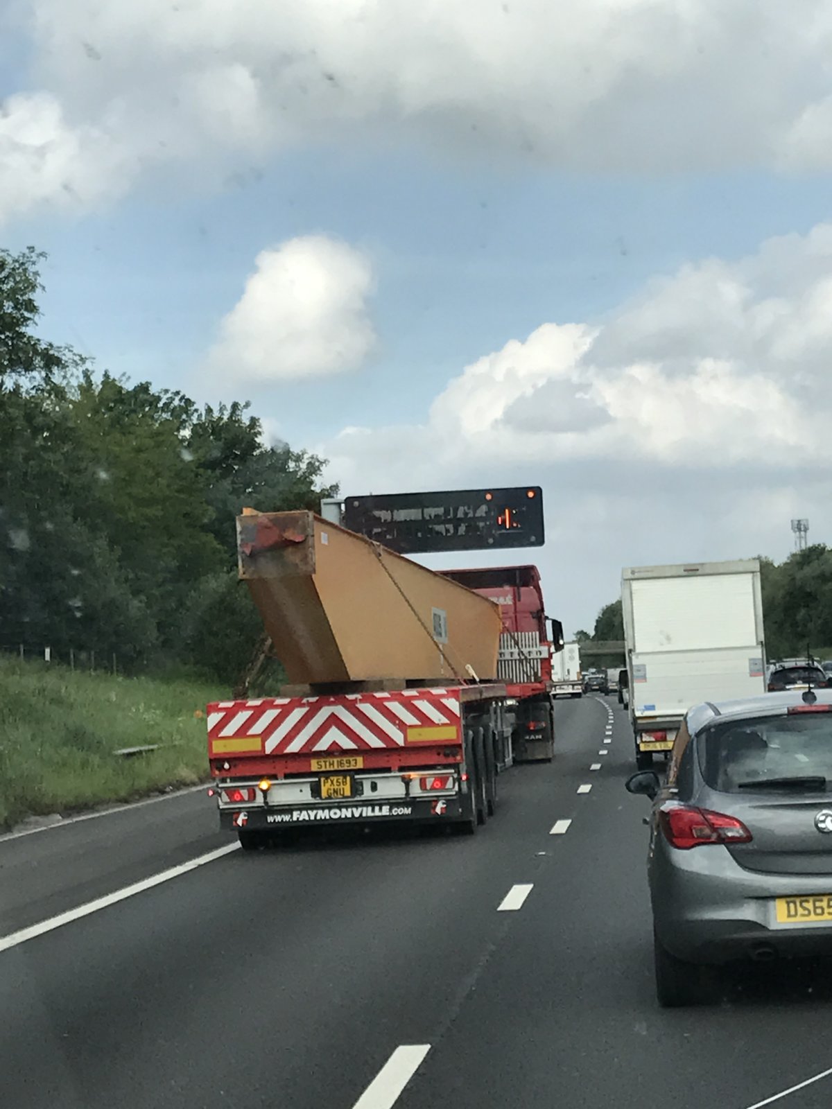

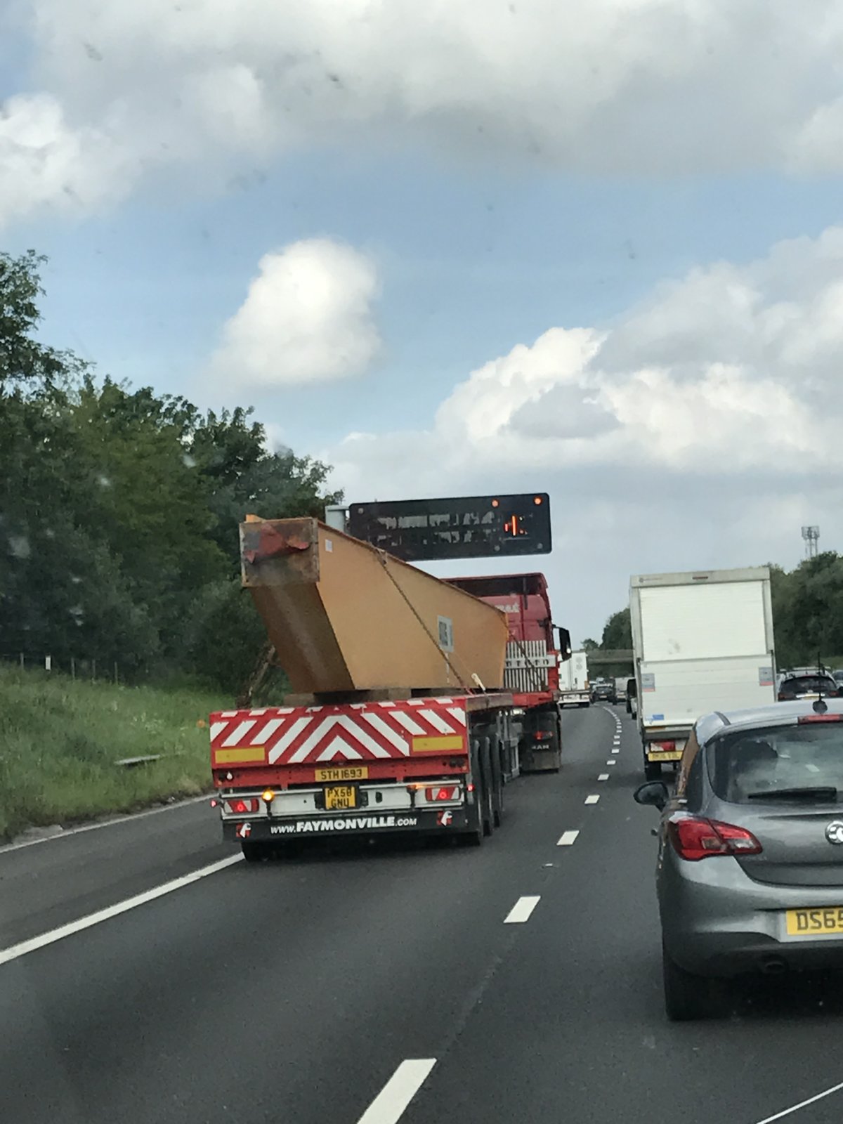

Mine came today, it's spanning 5.04mtrs:
