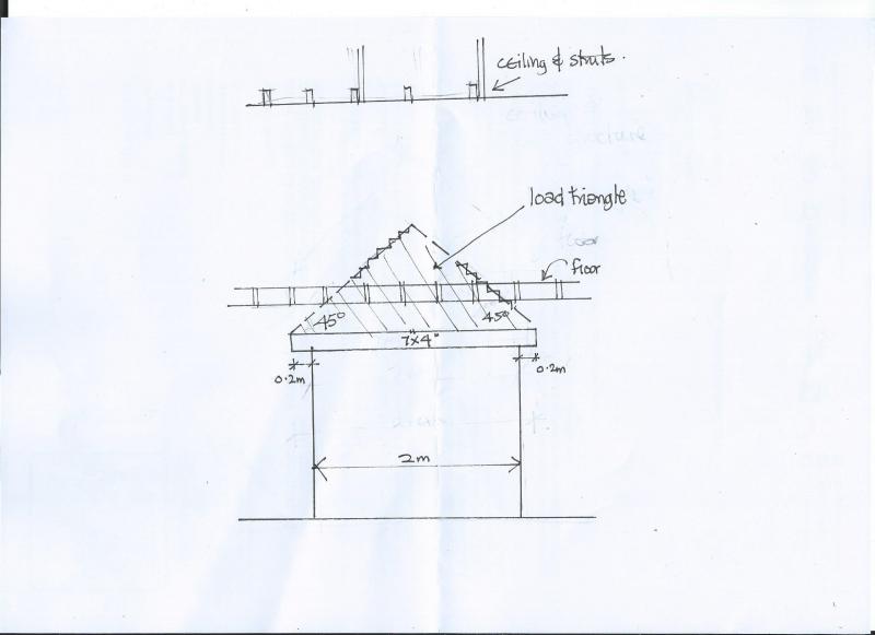

However phoned building control this time before putting an application and spoke to another officer. Explained to him and now I have been told that 7x4 not sufficient as roof struts are also supported on the wall on first floor. Been asked to get structural calculations.
Can someone shed light on this please. Why is 7x4 not sufficient for a 2 metre opening on a load bearing wall. Will 8x4 be enough.
Dont really want to fork out £200 for SE for something so basic when all i am doing is opening a wall, rather than taking out fullly.
This second officer you spoke with is also a nit.
Because of the 'arching' effect of brickwork, the load from the roof will have no effect at all on the beam. In fact, the beam will only be supporting a triangle of brickwork plus anything which crosses that triangle (eg the floor) - see sketch.
Most of the loads above the beam will be channelled down the brickwork each side.
A 7x4 on 215 conc pads will be more than OK.
