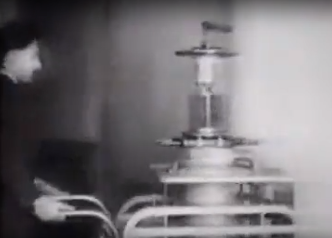

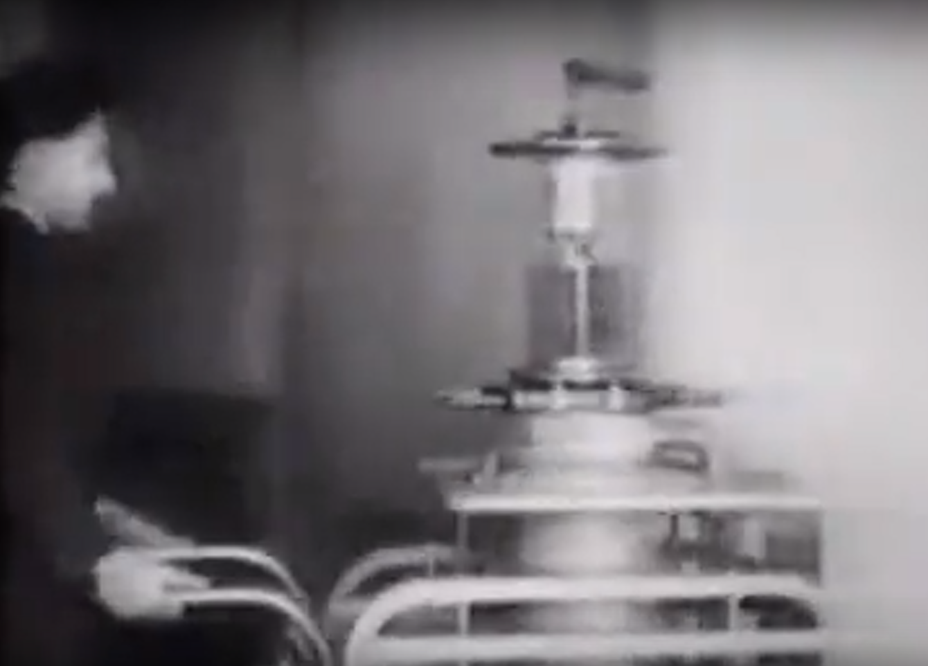

I have seen it claimed elsewhere that there are companies who can "rebuild" these large vacuum tubes when they wear out/fail.
Now, that, is certainly a possibility. I think DNJ thinks these things, are similar to what he sees in the back of his old TV. These are massively bigger, and liquid cooled.
Here is one of the earlier of the two beasties... In 1988, their replacements each cost £48,000.

I'm just wondering what type of engineer you would ask to design such a thing, and whether they exist off the shelf.
It only takes a small amount of Googling to find 500 kW transmitters for around 4 - 30 Mhz being offered (although I suspect they don't keep (m)any 'on the shelf'!), and I don't imagine it would take much effort to tweak such things for 200 kHz.
Pretty sure china has bigger ones since it has to cover a bigger territory. My old 24 inch sony monitor's CRT looked about that size. I didn't have a trolley. So, I had to roll it upstairs.
