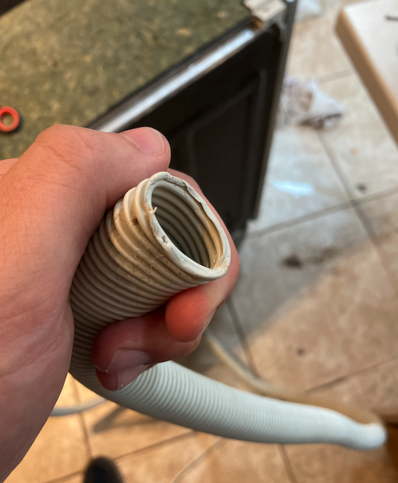

I have been given a Miele dishwasher but the rubber end of the hose has been cut off so I can't connect it to the connector that leads to my sink waste.
Is there a fix for this. I.e. a rubber part I can connect to the hose, or do I need to replace the whole hose?

Are you connecting to the spigot on the sink trap? A Jubilee clip worked for me.
Replacement hoses are cheap or you can soften the end of current with heat which will allow ribs to flatten and a jubilee clip to be used.
