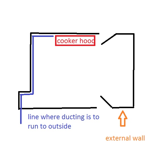

You can get longer tubing, but sods law says that with a 105mm core drill, it'll twist sufficiently that the tubing won't go through, so work with a larger core drill, and then fill the void with expanding foam, then cement front and back to hold it in position afterwards. You can get the grill and cowling seperately, and you just need to search for ventilation ducting for loads of options.
The caveat, is that it might be better to plan ahead, and use a 152mm hole, and that'll let you put a larger vent in later if necessary.

Thanks for the info as always Doggs, I'll make sure to upsize the hole as you suggest. Fully clear now on what I need to do. Photos to come.

Anyway I actually had some serious advice if everyone's behaving themselves:LOL:, if you find the tenants don't use the hood fit a constant mechanical ventilation with trickle/boost.
Trickle should only need around 15l/s in a kitchen so if you get a silent fan they won't notice, and it will flow through 100mm rigid round no problem.
Since it's silent they won't think to disable it.
