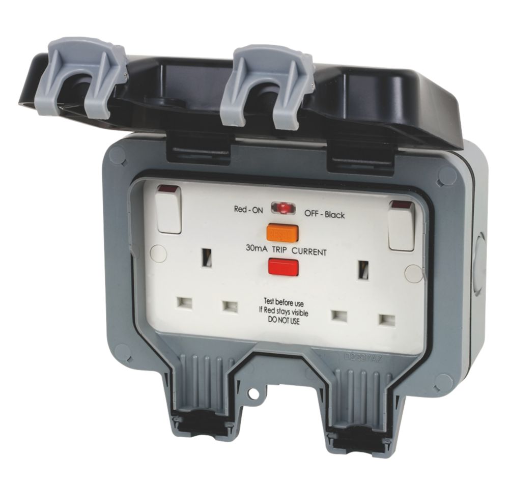

I want to install a 2G outdoor RCD protected socket as pictured below. I have an existing socket inside the house exactly on the otherside of the wall where I want to place the socket. I can spur off this socket. I can remove the socket and drill straight out to feed a 2.5mm2 cable outside and spur exactly on the other side with this double exterior socket. However, I would like to be able to switch that outdoor socket off completely from inside the house. So, what I am thinking to do is install a single 1G backbox next to the current indoor socket. Then spur from the existing socket to the 1G backbox which will have a 13A fused spur and then run the outdoor socket directly from that single 1G fused spur. Will this work? And does it meet the regs?

If the circuit you plan to connect from is RCD then no need for a RCD outdoor socket.
Nothing wrong with either method you have outlined. A method of double pole isolation for the outdoor socket is a good idea, in case of water ingress tripping your house circuit.
You don't need an FCU to provide that double pole isolation, a double pole switch will do the job, but so will an FCU.
I agree with Simon's points.
In addition, however, most people would say that you could not spur off the exisiting socket if it was, itself, already a spur from a ring circuit. If the existing socket is part of a ring (not a spur), or is on a radial circuit, then what you propose would be fine.
Kind Regards, John
Thanks for the replies. Simon you menion if the circuit is already from an RCD then no need for RCD outdoor socket. Is there absolutely no need or will there be no harm having it as extra backup?
John, I understand that you cannot spur off a socket if it's already a spur. I have checked the socket and it has 2 sets of wires going in and nothing is spurring from it. I read somewhere that generally if there is 1 wire then it means it's a spur and you cannot spur off it. If there is 3 then it means it has already been spurred from and you cannot spur from it. And if there is 2 then you can run a spur (unless someone ran a spur from a spur, which doesnt meet regs anyway) and considering its a new build with electrical safety checks done and I am the first home-owner since new, I doubt that would be the case. Plus worst case scenario if I am running the exterior 2G socket from a 13A fused spur then at least it's also protected by the fuse in the spur right?

If you have two RCDs in series, you cannot confidently predict whether one, the other, or both will trip, unless one is time-delayed.

John, I understand that you cannot spur off a socket if it's already a spur. .... And if there is 2 then you can run a spur (unless someone ran a spur from a spur, which doesnt meet regs anyway) and considering its a new build with electrical safety checks done and I am the first home-owner since new, I doubt that would be the case.
2 cables certainly suggests that it is not a spur, except for the caveat you have put in brackets there - which may not be as much of a certainty as one would like to think!
Yes, that would protect everything downstream of the FCU but, if you were spurring from something that was already a spur, then that would be contrary to guidance in the regulations, and might theoretically overload the cable feeding the existing spur(s). Having said all that, your interpretation is very probably correct!
