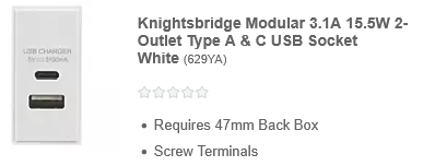

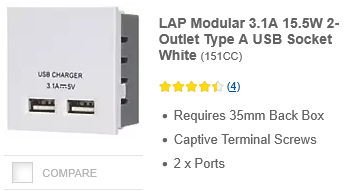

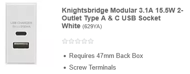

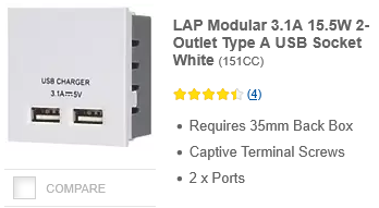

I have a fused and switched 1g spur which is spurring from a mains socket that has been spurred before. From the switched and fused spur I have a 2.5mm2 twin and earth going approximately 70cm up a safe zone to one of the follow 1g BG usb socket. I will be only using this socket only for the usb-c and maybe usb-a charging ports. I will not be using the socket itself. Should I keep a 13a fuse in the spur switch? Or since I’m only using usb could i reduce to maybe 5a?
If you only want USB then just fit USB 1760986686829.png1760986774611.pngThere is no reason to fit a 13 amp fuse to protect a 13 amp fuse. Only one is required. Units shown are grid switch modules. See for LAP plate and and Knightsbridge here
