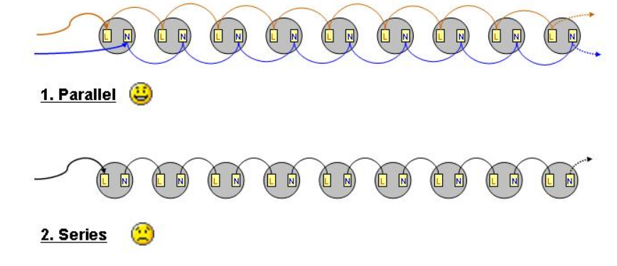

So assuming I can’t get 4 cables into the terminals of the existing socket, can I go:
ring socket > 13A FCU supply > 13A FCU load > new socket > 3A FCU supply > 3A FCU load > alarm
I understand the 13A FCU might not be required but it allows me to avoid 4 cables in a socket, plus I always tend to air on the side of too careful!
This also seems to align with the ‘put whatever you like after the load side of an FCU (within reason)’ ethos, so adds a bit of protection if changes are made in the future?

last thing, and I might be repeating myself, it it would be a tidier cabling job to bring 2 cables out of the load side of the 13A FCU. One to the new socket, the other to the 3A FCU going to the alarm.
Is that ok, or must they be connected in series as my first suggestion above?
You did not suggest connecting them in series and you must not do so. They must be connected in parallel.
Sorry, I may not be using the right terms here.
What I mean is, everything in a row after the 13A FCU, or splitting from the load side of the 13A FCU and going to the socket on one cable and the alarm on another.
johns posts suggest that either would be ok, it is there something I’m missing?

Don't worry. We all knew what you meant, including the person who loves taking people to task in relation to that particular bit of 'incorrect terminolgy'.
What I mean is, everything in a row after the 13A FCU, or splitting from the load side of the 13A FCU and going to the socket on one cable and the alarm on another. johns posts suggest that either would be ok, it is there something I’m missing?
You're missing nothing.

Then we'll get: "Someone on DIYnot confirmed connecting lights in series was alright".
Ah, I see. I was being too liberal with the word series! Thanks for the clarification in any case.
I won’t be cross connecting any lives and neutrals, that’s for sure!
