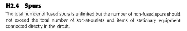

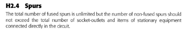

You can probably forget the 'until recently' biut, since even the current version of the OSG says:
That seems to make absolutely no electrical sense - and (in my opinion) to add the distinction between fused an unfused spurs just adds insult to that injury!
Kind Regards, John
Surely there referring to the drawing in appendix 15, and there "Fused" is referring to unlimited if the fuse is in the first spurred point or "unfused" as in spurred direct of the ring, they must not exceed the total number on the ring , but as you know still limited to 1 single or double at each joint.
