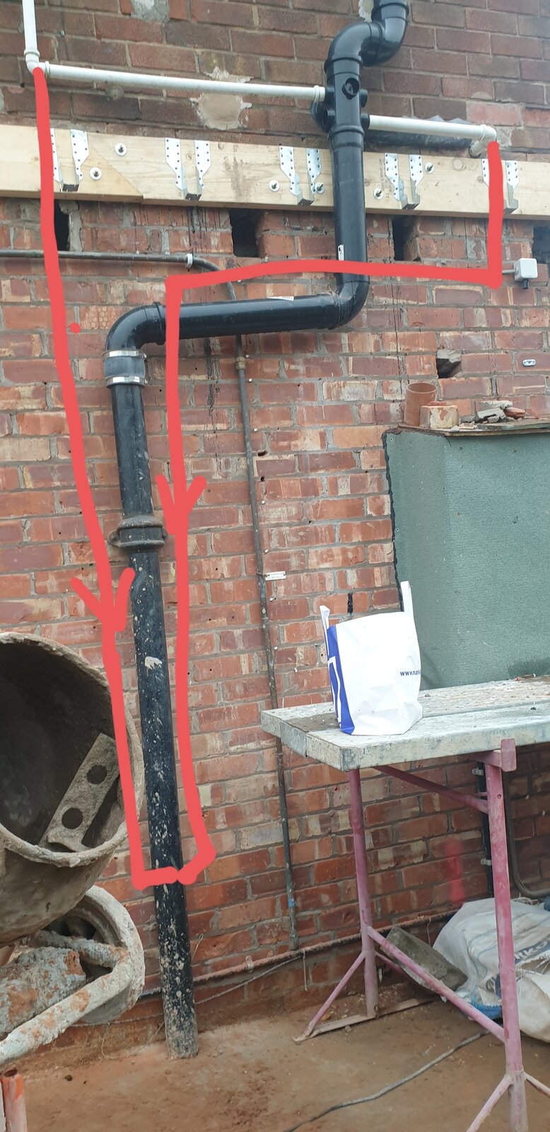

The current waste stack on my house won't be needed much longer. I'm having a side extension that has a new open vented stack on the gable wall. The toilet waste will be re-routed to the new gable wall and into the new stack. My basin and bath waste currently run into the same existing stack.

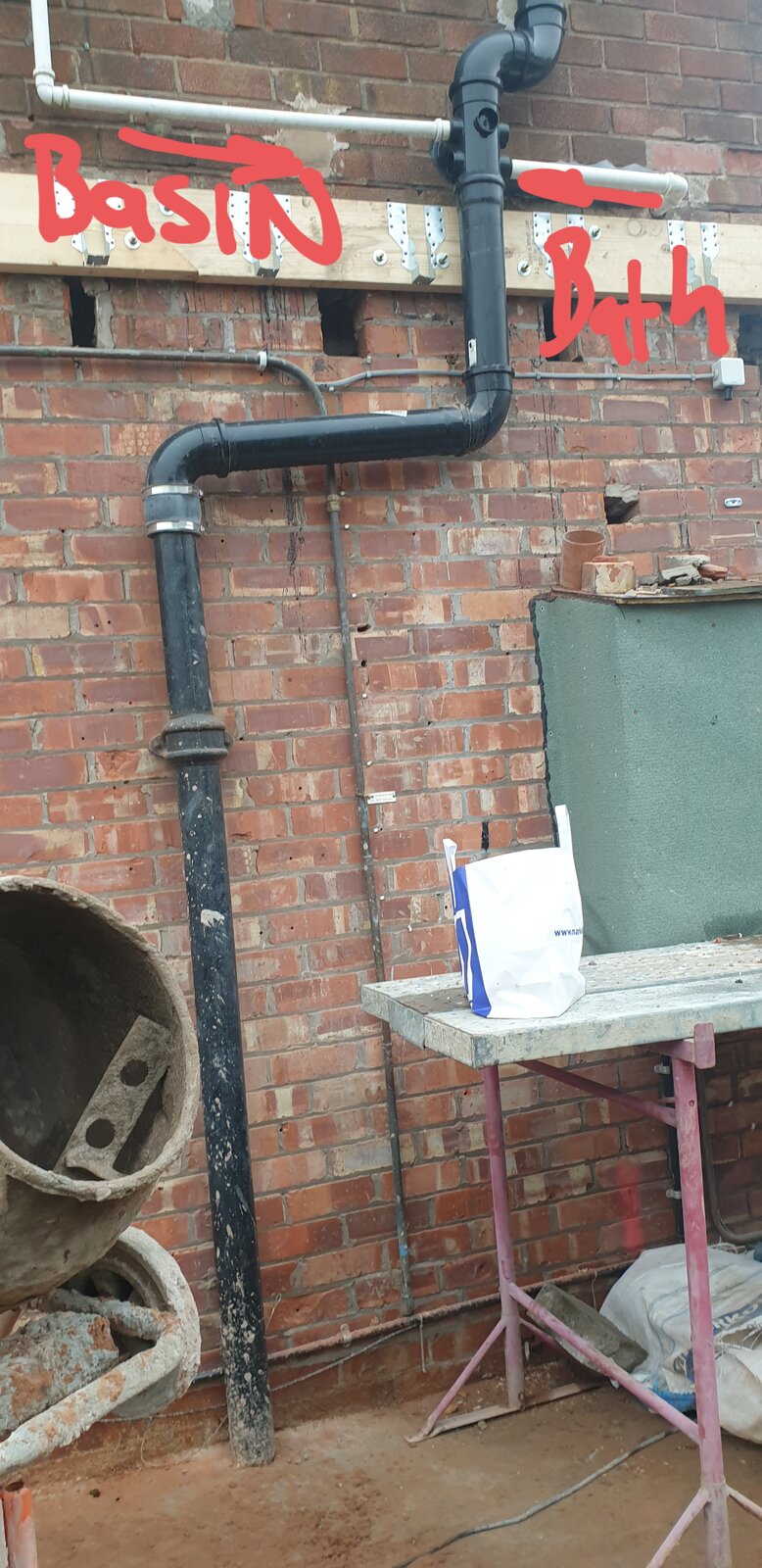

I need to re route my basin and bath waste as they will be inside a new bedroom and they currently run into a stack that is to be removed.
Is it allowable to cap off the existing soil stack near to the floor and run the basin and bath waste into it? Pictures will help explain what I mean....
This is the current (temporary) set up. The main pipe is cast iron the toilet and both wastes run into it. The toilet waste is being routed as shown below....

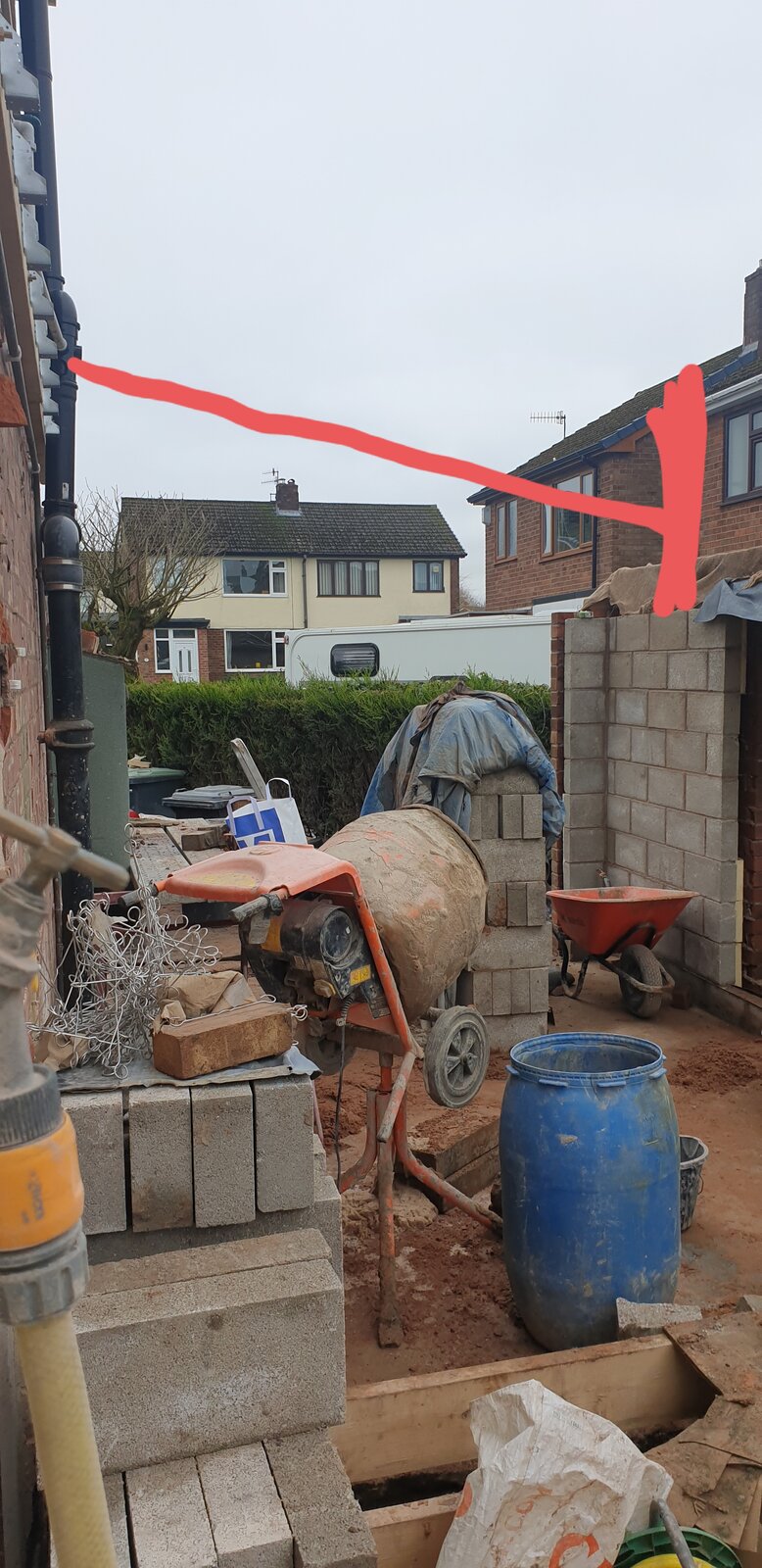

It will be run between the 1st floor joists to the gable end and into a new stack.
