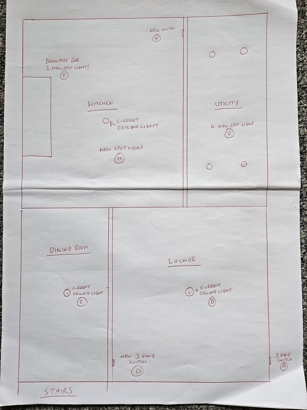

If anyone here has a bit of spare time to advice me on the following, l would really appreciate it.
The plan is not to scale but l hope my explanation makes sense. I have given each area a letter to make it easier.
Ok so.....
1)Currently Switch A operates the porch light, lounge & dining room.
* l would like it to operate the porch, new spotlights in lounge & (separately) new spotlights above a shelving alcove also in the lounge.
2) Would like switches D to also operate lounge spotlights (2 way) and stair/landing light which is 2 way but moved into the same switch, and to operate new spotlights H in kitchen. H needs to be operated by switch E also (2 way). In same switch E for utility.
3) Switch E needs to operate the spotlights G in utility but on/off only.
4) Breakfast bar 2 new spotlights F to be operated on/off on its own switch.
Can you tell me the routing of the new cables, which type of cable and what switches/gangs l need to get for each area. Any questions please ask and l'll do my best to answer.
Thank you in advance.

In the main, the problem is getting wires from A to B, and problems then redecorating, so there are a host of ways to control lights with wireless methods, the second problem is lack of neutrals at a switch.
Clearly, power needs to go to the light, but not always the switch.
To get power to the light, one can use a lighting track, it may only do the same as a bit of trunking, but makes it look as if designed that way, rather than an afterthought.
