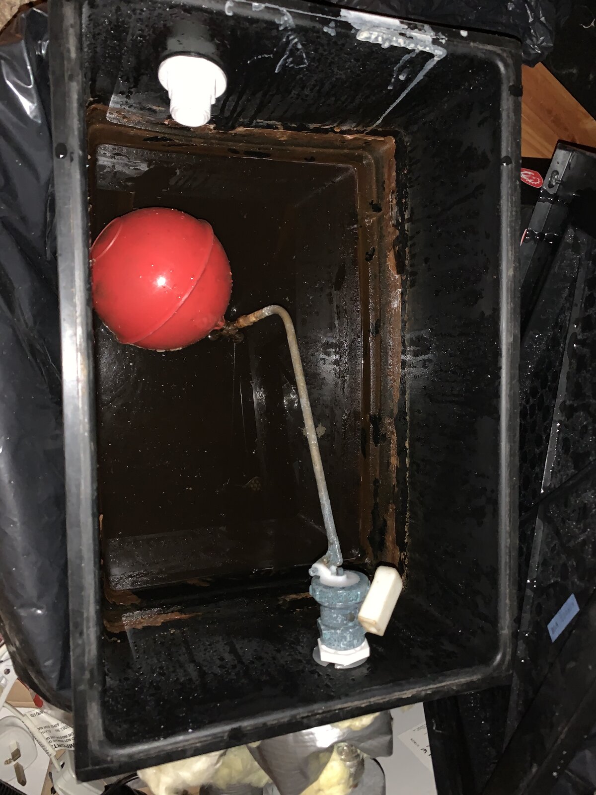

I have been in the loft and the water tank has water in (above the out/lowest pipe, but way below the inlet attached to the ball valve - the only other pipe attached is the overflow). Oddly no water comes out of the ball valve/inlet when the ball valve is down, but there is plenty of water in the tank. Could it be filling up from somewhere else on the system? The engineer did say the pressure on the radiator didn't really drop when putting bungs(?) in the tank, so had to switch off mains water before changing the valve.

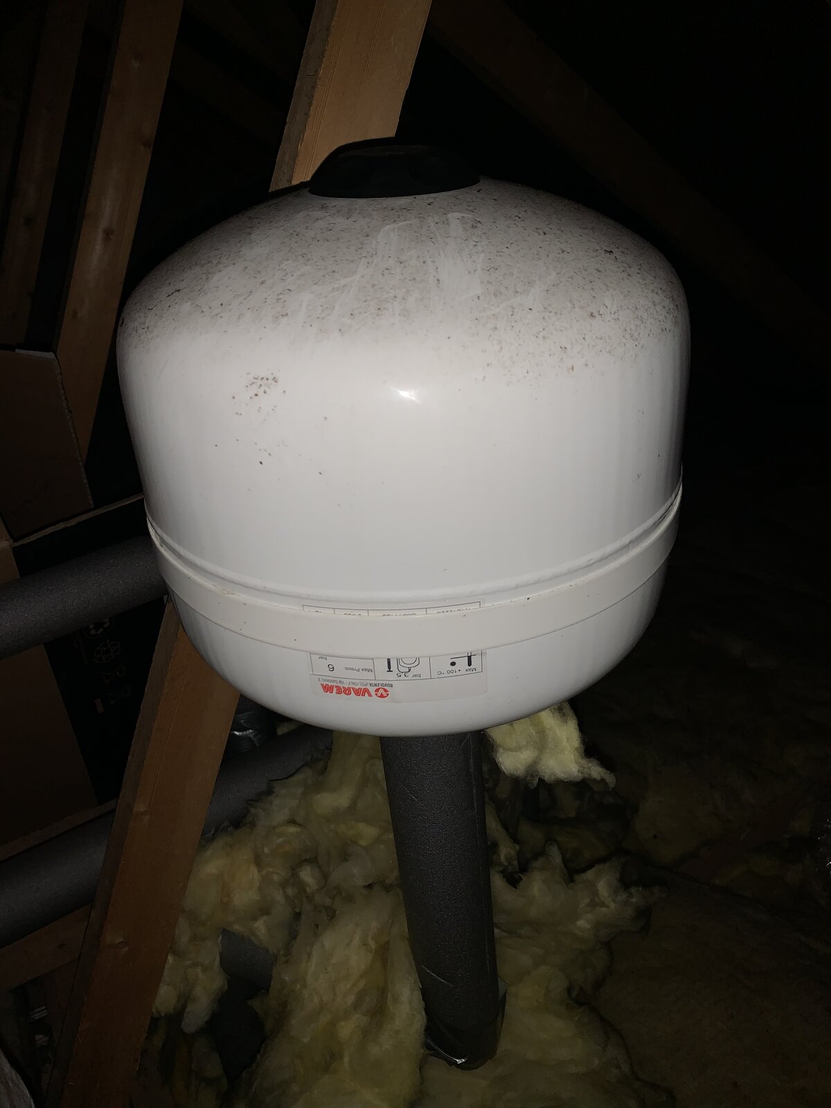

We also have a metal balloon type that seems to be above the shower (it is Varem and says "Max Press 6 bar" on the label) - it has a tyre type valve for attaching a pump? Is that related to the heating or shower and would that affect the issue I am having?

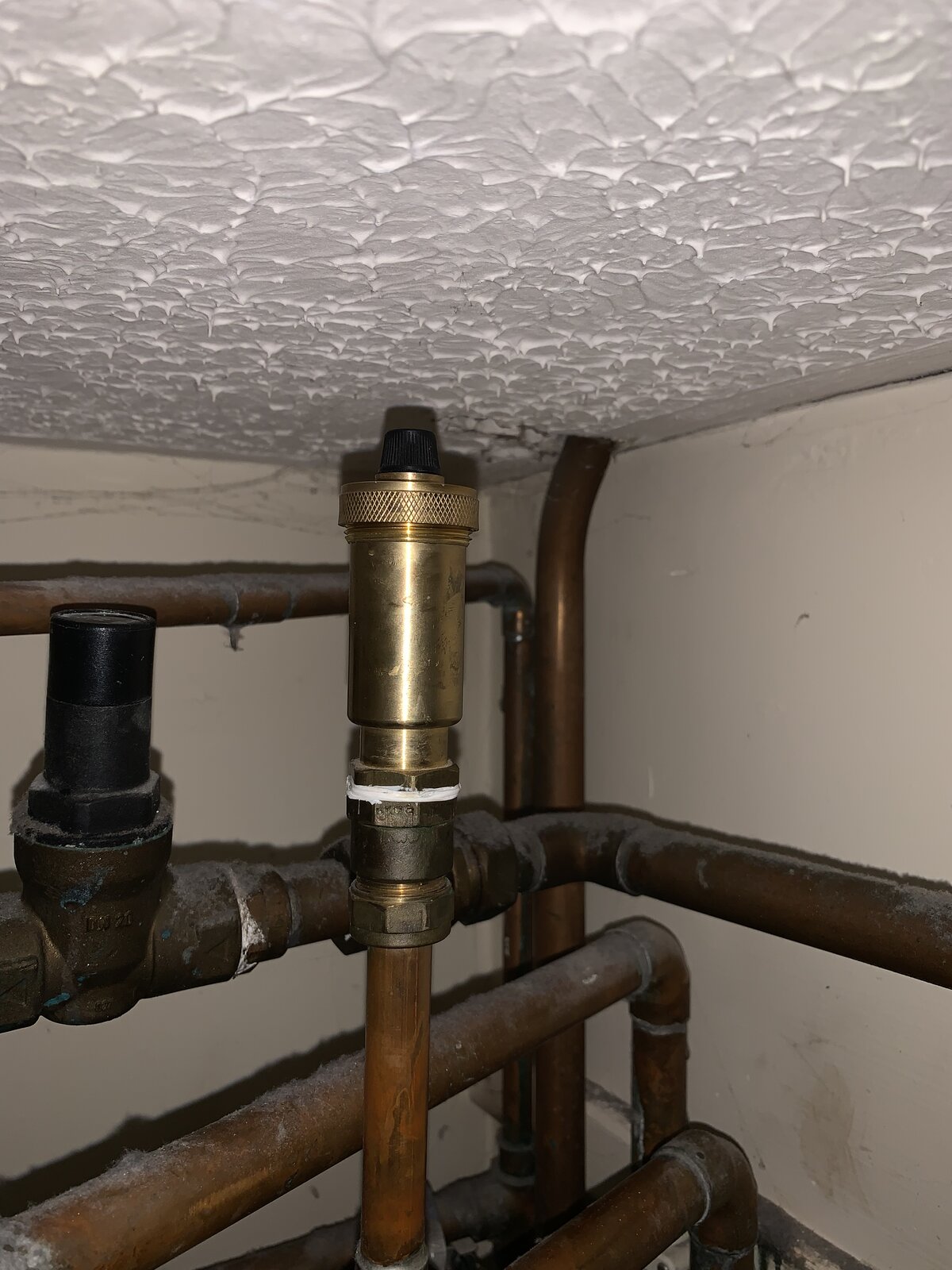

I seem to have solved the running water sound. I didn't realise that the top right could also be turned to release air (I had just turned the small one in the middle).

Feeder tank level has dropped slightly which suggests it has taken water in. No running water into the tank though, so it may be the ball valve needs replacing (engineer mentioned it may need doing at some point soon, but must have somehow got water running into it to top up the system).

This was the metal balloon with max 6 bar indicated on the label.

That's an expansion vessel for domestic hot water.
If the ballcock is not allowing water into the tank when you press down on it ,you need to investigate why,and fix the issue. It's either isolated ,or blocked or needs replacing.
Thank you. It was your suggestion to take photos that prompted me to take a closer look at all the pipework above the hot water cylinder. While at eye level to take the photo I then spotted the top of the other big valve could unscrew to let air out.
1. If the "small one in the middle" which you turned (your 1st photograph) is the one with the black plastic top half, that may well be an automatic bypass valve.
2. The auto bypass lets hot water pass directly from flow to return when all valves are closed, to save damage to the pump.
3. If you have altered the setting you might have to reset it. There are various videos on how to do this available on the internet.
No, sorry, I uploaded the wrong photo - the middle valve is small and bronze (not in the picture). I didn't touch any of those with plastic caps as they didn't look like they should be removed.
