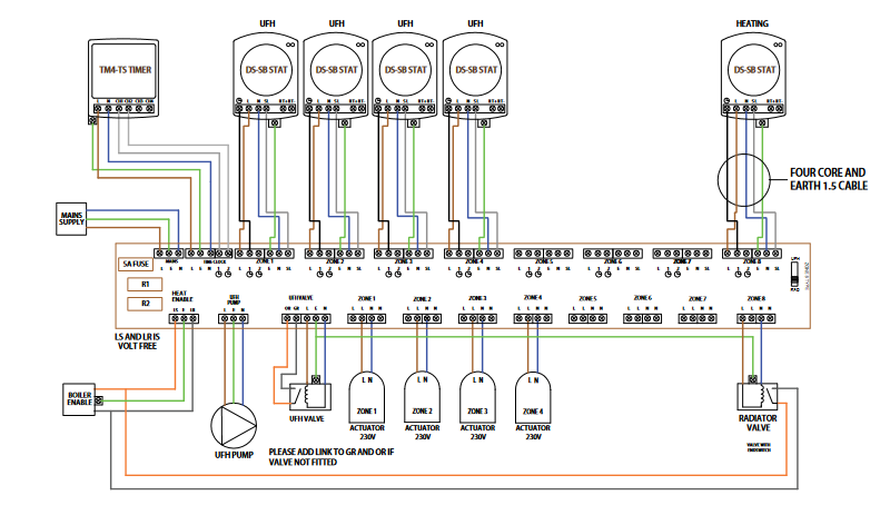

I am looking for some help if i may. The house was re plumbed a few months ago and i am now having the electrics completed.
As part of the electrical finals i have asked the electrician to wire the central heating/Hot water system so that i can finally do away with running the boiler for a few hours a day to give me hot water to have a shower.
He is happy to do it but is a new build 1st/2nd fix guy and says the plumber normally deals with it. All he wants is a schematic for him to follow and i am good to go.
I have watched a number of videos as i like to understand what is being done and there are millions of drawings online but none seem to be quite identical to what i have which is strange as its a very common set up.
WB Greenstar System boiler (located in garage)
Megaflow cylinder (located in the loft)
Nest 3rd gen stat & heatlink
1 heating valve feeding rads upstairs
Upstairs temp controlled by Nest
1 heating valve serving UFH downstairs
Downstairs heating controlled by multiple stats connected to the UFH manifold
1 valve serving CHW controlled by nest programmer
I understand that i need an S Plan + set up.
In my head i had the heatlink and wiring center being located in the loft next to the cylinder with a link between that and the boiler.
There are spurs available at the boiler and loft locations for mains power.
Does anyone have a schematic showing the wiring that i can give him to wire to?
Any help is much appreciated.

In the main the radiator zone is part of the UFH system with something like this.
Top right you can see the heating thermostat, taken from the "UFH heatmiser UH8 instructions" the Nest Gen 3 does not really lend its self to combining with the UFH as shown here.

I thought the underfloor heating has its own heating system that takes information from each of the stats to each of the zones/rooms and opens valves on the manifold to feed hot water round the system when required.
That system is then linked to the main control hub which triggers the 3rd valve asking the boiler for hot water when called for by the UFH manifold. Is this not the case?

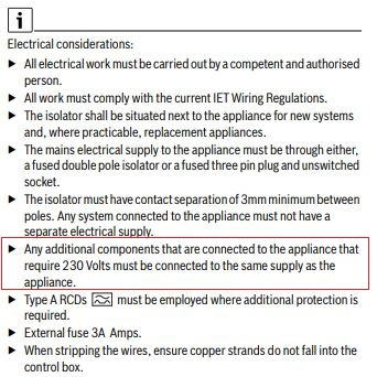

Only one of those can be used, the whole system must be supplied from one only so it can be isolated at a single position.
The Nest part is a standard S plan.
Nest 2 channel receiver, wired to one valve & cylinder thermostat for the hot water cylinder, and another valve for the upstairs radiators.
The UFH is wired according to the instructions supplied with the UFH wiring centre and thermostats.
That's exactly how it is.
It's a standard S plan, with the addition of a 3rd valve which is controlled from the UFH wiring centre / control box.
This is the normal way of doing things, however having a thermostat fed from a USB supply with Nest Gen 3 is common, and unlikely the USB supply is taken from the single FCU supplying main boiler, it does not really matter if a power supply is built into a thermostat, or if independent the rules clearly need to be the same. So either the USB supply needs to be supplied from same FCU as boiler, or no other power supply needs to be supplied from same FCU either.
My boiler when I moved into the house had at least 3 FCU's feeding the central heating, and they came from two independent distribution boards. Today there is only one FCU, but 10 independent supplies, 9 of which are pairs of AA batteries.
I would agree safer when turning off one FCU turns off all, using multi-FCU is asking for errors with borrowed neutrals, and for errors to be made when proving dead, but there is no strict rule saying all supplies to central heating should come from one FCU, from a single isolation unit yes, that would be normally the main isolator on incoming supply.
I would agree the manufacturers instructions often say some thing like
but it does not define same supply, with domestic I have not seen it where there are multi-supplies, so it would always be the same supply. In the building I work in yes, there are at least 3 independent DNO supplies, but that would be unusual for domestic.
Surely as someone competent working on the system would check if something is fed from a usb supply/plugged in to a socket outlet and could use knowledge that it’s fed from a different source. If the Nest was being fed from the heat link, then this would need to be from a single fcu source same as the heating system. I think you know what @flameport was referring to, I certainly did.
Yes agreed, but a blanket statement only one FCU is misleading. It does depend on how it is all installed, in some cases there may be more than one circuit = An assembly of electrical equipment supplied from the same origin and protected against overcurrent by the same protective device(s). remembering that many do not consider fitting a FCU as forming a new circuit, if fitted to a ring final then as the name suggests that is the final circuit, so how can a FCU form a new circuit if taken from a ring final?
True. Would it be looked at as tee-ing into the ring main and spurring off (as the name suggests), then it’s a new/additional circuit?
English language final is the last, so ring final is the last circuit, however it does not say same circuit, it says same supply, and most homes only have one supply.
The problem is many thermostats, hubs, and programmers are not volt free. And if not volt free then it must come from the same overload device, it does not matter if the fuse is built into the boiler, or a FCU fitted onto the wall, and many boilers are designed to be controlled by low voltage or extra low voltage and have provision to take the supply for the controls from the boiler as seem here OT-lodgic.jpgoften with separate provision for low and extra low voltage.

A lot of waffle for what is a very basic setup consisting of 2 heating zones (1 heat zone comprising the underfloor) and a hot water zone. This should be incredibly easy for any half capable electrician. The only awkward bit to remember is to turn the hot water disinfection off on the nest or you will think there is a fault as it does an hour hot water without demand once a week or after every period of electric isolation
