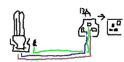

Yeh it's a 11W? Or something, Tesco CFL bayonet with a fitting, I am plugging into a three pin BS 1363 standard wall socket, using a male 13A fused plug, using wire which has blue, brown and green/yellow wire in it.
At the plug -
Brown to Live
Blue to Neutral
Green/yellow to Earth
At the lamp -
Brown & Blue to bayonet fitting. It doesn't matter which way round.
Green/yellow to Earth if there is one (metal fitting). If there isn't one (plastic fitting) put connector on the end and tuck out of the way.
Edit - Didn't see your drawing - that's right but use 3A fuse.
