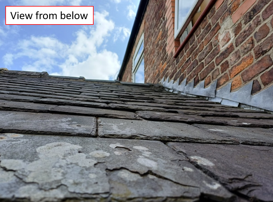

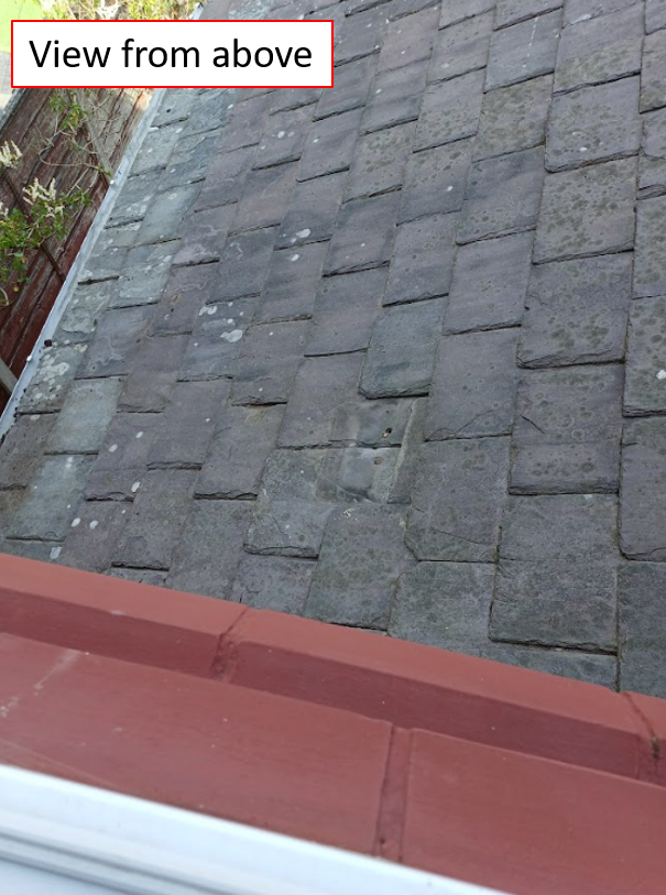

Hi,
This roof needs a new slate. Question: Will walking on this cause damage?
Many thanks,
Gil
Probaly not. How heavy are you? Average bloke with soft soled shoes should be okay to walk up that slated roof. Place each foot over the battens and carefully transfer your weight and all should be well.
Thanks for the response.
I am average build, around 11 stone.
When you Google this issue, lots of people seem to advise against walking on older slate roofs.
11 stone should be fine whereas a 15+stone chap might damage the slates. Roofers have been carefully walking up slated roofs since slate has been used as a roofing material so they can't all be wrong. Years back I've walked up many and never damaged a single slate inc my own Victorin villa. Of course, if a slate was about to fail, then it would crack, but that can't be anticipated.
