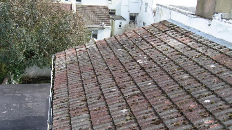

There is a lot of moss over the kitchen extension that I would like to scrape off with a trowel.
Is it reasonably safe to walk on the roof - I am not a roofer, but competent diyer ? (safe for the roof that is - I am not worried about myself)
I just figure that that is exactly what a roofer will do and I might as well do it myself.

I'm not condoning walking on a pitched roof without any fall protection. Despite doing it myself from time to time.
If you DO, spread your load. Wear soft shoes or go barefoot to prevent point loading on the tiles. ensure that each hand and foot is on a different tile. Do not try and walk on just your feet.
Also, be extra carefull around the edge.
Similar to walking across a frozen lake.
It's also advisable to have someone around to call the emergency services if something does go wrong.

Spreading the weight is more to protect the indevidual tiles than the roof as a whole. I once tried to walk out in boots and snapped a tile in half.
Walk on the headlap of the tiles, that way you are supported by the batten below the tiles and will break fewer tiles if any.
Whilst up there, if moss is a regular problem it would be worth thinking about putting a copper strip at the high point of the roof to minimise future moss growth
Do not go accessing or walking on a roof with bare feet - period.
You have access from the flat roof below to use a long broom and a hose to clear what little moss exists. No need to go on the roof.
Plus, some of the tiles look to be de-laminating and could be sodden and or brittle.
Clear your gutter before and as you clean, dont allow debris into the down pipe.

We often make up roof ladders on site using tile laths, cut and screwed together, and hooks at the ridge end. We tie them to our ladder(s), which are tied into the fascia or brickwork.

Just use a spray on moss killer and let the rain wash it off.
I would be inclined to tape a scraper to a broom handle and just reach up from the ladder. Finish with a broom afterwards.
