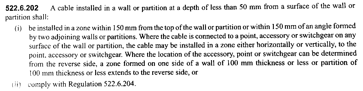

I heard that running up alongside a door frame within 150mm is also considered a safe zone, is this true?
"also not shown it is additionally considered a 'Safe zone' 150mm at sides of door frame.
The aim being that it is unlikely anyone would hang a picture say in the area as it would over hang the door way."
Source: https://www.diydoctor.org.uk/forums/cable-safe-zones-t24663.html (see last post).
