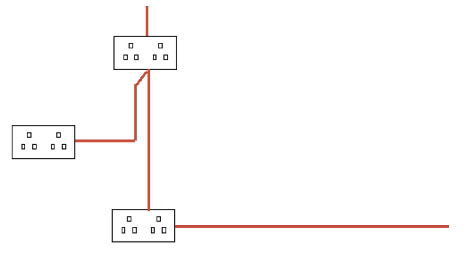

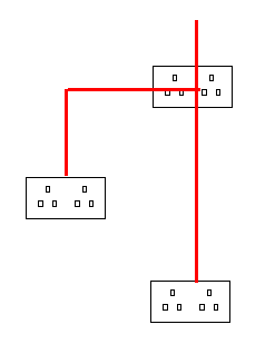

Hi folks,
I think I'm probably just being silly. If you look at the two arrangements of wiring between 3 sockets on a radial circuit I've shown below, something doesn't 'feel totally right' to me in relation to the 'safe' (aka dangerous!) zones - I think probably because the right-angled bends in cable routes do not occur at an accessory.
However, in terms of what the regs say (and the way we interpret them), there seems to be no doubt that the cables are all within 'safe' zones, as defined by the sockets.
Am I just being silly/'overthinking'?
Kind Regards, John
I think you are 'underthinking'. What is the problem?
All the cables are in safe zones created by the accessory to which they are connected.
I might have understood your question had you drawn external right angles.
I think you are 'underthinking'. What is the problem? .... All the cables are in safe zones created by the accessory to which they are connected.
Indeed so. As I said, I can't see any problem, just an unexplained 'uneasiness' :-)
What do you mean by 'external right angles'. If you mean something like this, that would be equally fine, wouldn't it?
Yes, that is what I meant.
Equally fine - but your question would have been more understandable.

I was referring to a 90 degree change in the direction of a cable route - within an accessory at 'A', but not at 'B' ...

Yes, but they are all connected at A so it's not a change of direction at A.
That, of course, is my point - that when cables emerge from an accessory in directions at right angles to one another, they are usually (but not inevitably) 'connected' within the accessory (such that no individual cable 'changes direction'), whereas the cable itself does 'change direction' when the bend occurs other than at an accessory.
What is?
If a cable is not connected then the accessory does not create (cannot be used as) a safe zone for it.
Of course, two other accessories might create a safe zone which passes through (at a right angle or not) another accessory to which the cable is not connected.
So what?
