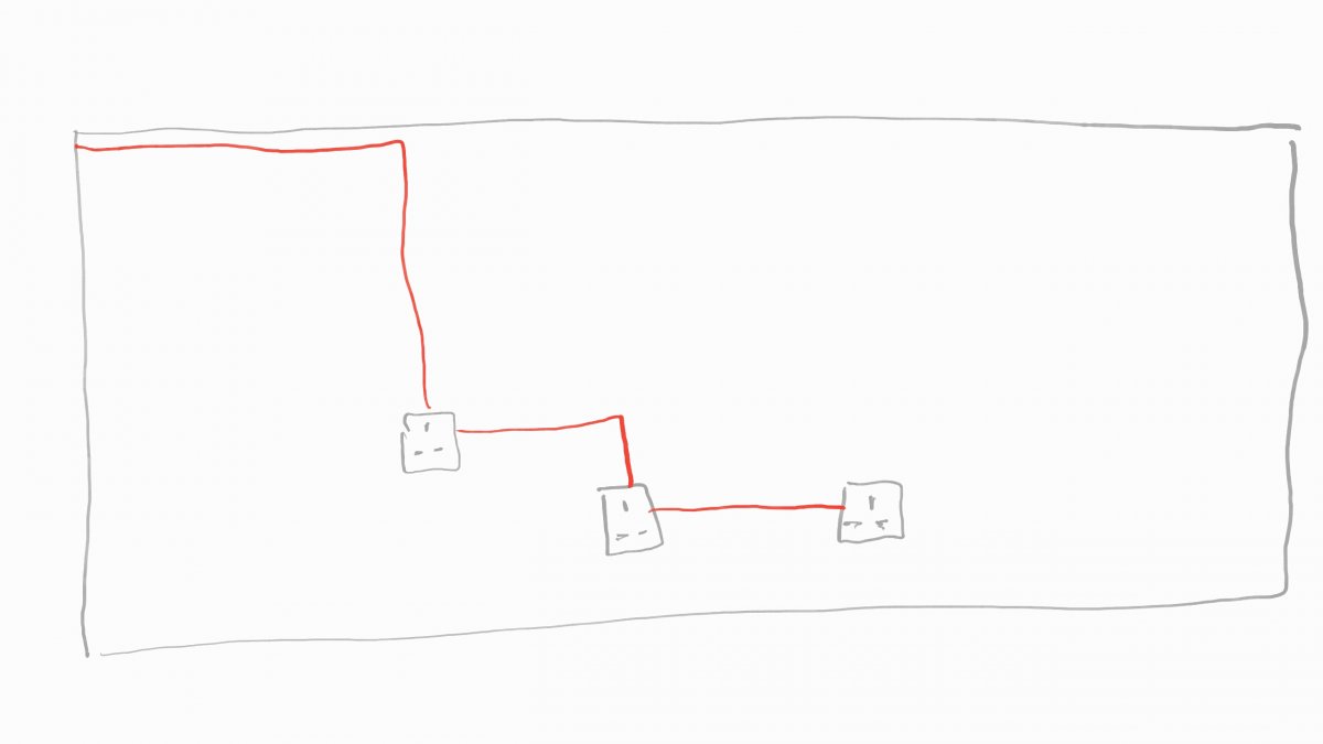

Hi all,
Hopefully an electrician can tell me whether this is wrong or right? I'm planning on spuring off a circuit with 2 extra sockets. Regarding running cables within the safe zones, would these cables be within the safe zones?...as the cable is running horizontally and vertically to the new sockets.
Thanks for any advice given,
Paul

Yes. Assuming the top line is within 150mm. of the ceiling.
If you haven't done it yet, then I would prefer down from the first socket and then right to the second. I.e a big L apart from the top line.
If that spur is off a ring final it does not comply. You can only have ONE socket (single or double) on a spur not three.
You can do it, but you would need to install an FCU (with 13A fuse)
before the first socket in your diagram.
NO! The cable must run horizontally or vertically between the accessories. Your middle section doesn't comply.
I beg to differ. The safe zones created by accessories go an unlimited distance (until they hit a corner, wall or ceiling) horizontally and vertically from the accessory. All parts of that 'middle section' of cable is therefore in one, the other, or both of the safe zones created by the left and middle sockets.
However, as has been pointed out, quite apart from safe zones, if they arise from a ring final, those three sockets cannot be run as an unfused spur.

Pretty much what I wrote. The cable must run horizontally or vertically between the accessories.

Fair enough. That would, however, seemingly be somewhat restrictive - for example, quite apart from dictating accessory location, it would presumably not allow a cable to run to an accessory unless there were some other visible accessory that it was running to? How is it meant to work with cable drops from above ceiling, or below floor, to light switches, sockets etc. - are they 'forbidden'?!

It's an IEC WD for an amendment to the relevant part of 60364, so not (yet) part of the BSS. It doesn't forbid switch drops, etc, it just means that unless two accessories are visible there are no zones that are considered to be safe zones.

Interesting. Thinking about several of the rooms here, it would seem that would mean that in most of them there would be no 'safe zones' (or, at least, useful ones) at all. About the only exception is in the kitchen, where there is a horizontal line of sockets - although, ironically, far from all of them are connected by horizontal cables!
Is this likely to get incorporated in future editions/amendments of BS7671? ... and, if so, are all cables buried in walls likely to be outlawed (unless they are in conduit or have earthed coverings)?
