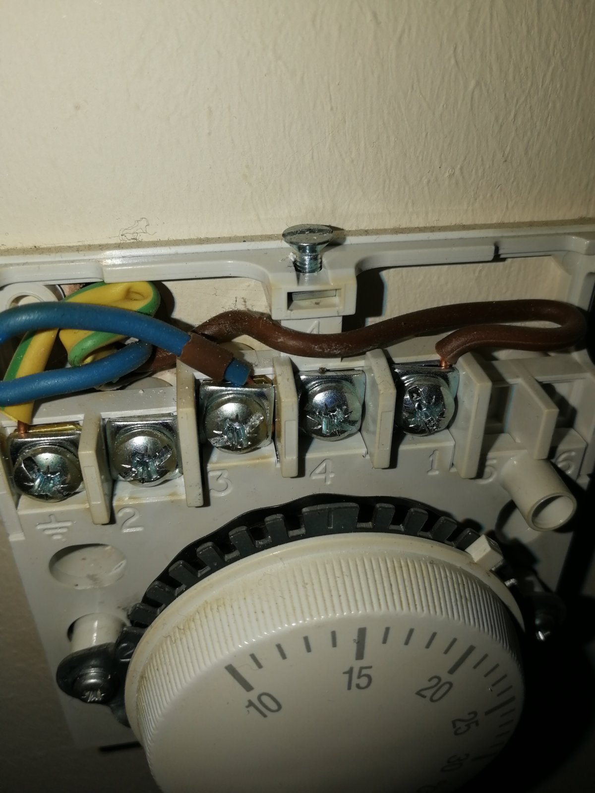

Hi just got salus rt300rf to replace a dial thermostat. my issue is there is 3 wires to dial. one blue one brown and yellow green wire so 3 wires im not sure where yellow green one goes in the receiver.. We have a fused switch that cables come from to turn boiler on and off so boiler cables go into that then those 3 wires come from that to the thermostat any ideas
Yellow & green is normally Earth but it sounds like the incorrect colour has been used in at least one terminal of your thermostat so you'll need to post a picture of the existing wiring before we can advise further
That is how they are in the dial thermostat..... Then those wires go to the fused switch behind the wall next to the boiler

OK G/Y is Earth, Brown is permanent Live in and blue with a brown band around it is switch live out.
Your Salus isn't compatible with this as you also need a Neutral connection for it, which you don't have, so you'll need to rewire or buy something else
The existing thermostat is incorrectly wired, it should also have a neutral wire connected to terminal 2. It will work however, but its accuracy won't be as good as it should be. The wires are identified as
The wire in terminal 1 is the live supply from the timeswitch / programmer
The wire in terminal 3 is the switched live to operate the heating.
At the Salus receiver:
Terminal L is the live, which should also be linked to the Salus Com terminal
Terminal NO is for the switched live
However, you also need a neutral for the Salus receiver. So you will need to pick this up from elsewhere in the heating circuit

The existing thermostat won't work very well, because...
If you buy a simple replacement thermostat that is battery powered (the batteries last several years) then you won't need a neutral, and it will be a simple exchange. Here are a couple of examples.
