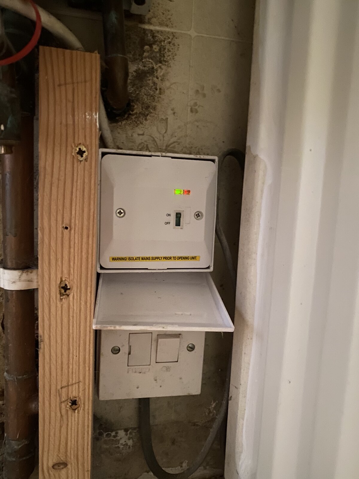

Hi Can anyone help me please?
I seem to have a issue with my heating system, my boiler is working i.e. I have hot water and ignition but no central heating is firing up when prompted by the wireless thermostat, the thermostat is working and it's connected with the receiver, I have both the green and red light on when I put the temperature up and when turning this off I have just the red light. However when the green light is on the heat call does not seem to connect with the boiler as this is not firing up.
Is there something i can do about this? or do i just have a faulty receiver and will need to buy a new one?
Any help is appreciated as the cold house is driving me mad!

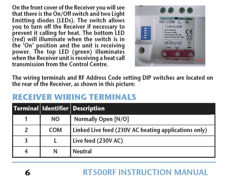

At the back of the receiver you may have some terminals looking like:
With the power turned off (to the boiler and receiver), you can connect together the wires in the NO and COM terminals (put both wires into the COM terminal).
If, when the power is turned back on, the boiler fires up, then the receiver is probably faulty.
If the boiler doesn't fire up, further investigation may be necessary of the wiring, or the boiler and you may need an RGI.
If there's anything you are unsure about, let us know and include a photo of the wiring behind the receiver.
I hope that helps :)

my receiver it not in a very easy reach area, as I just trying the above and the heating came on as I have a program to start at 7pm till 9pm, and that program seems to be the only one working as it did not came on this morning. As the heating is now on I am assuming the receiver is working?? I have been trying the override mode but this is not working, I get the green light in the receiver but the boiler won't start..
I will leave the heating on now and see if it stops at 9pm. As at least will heat the house for a bit.

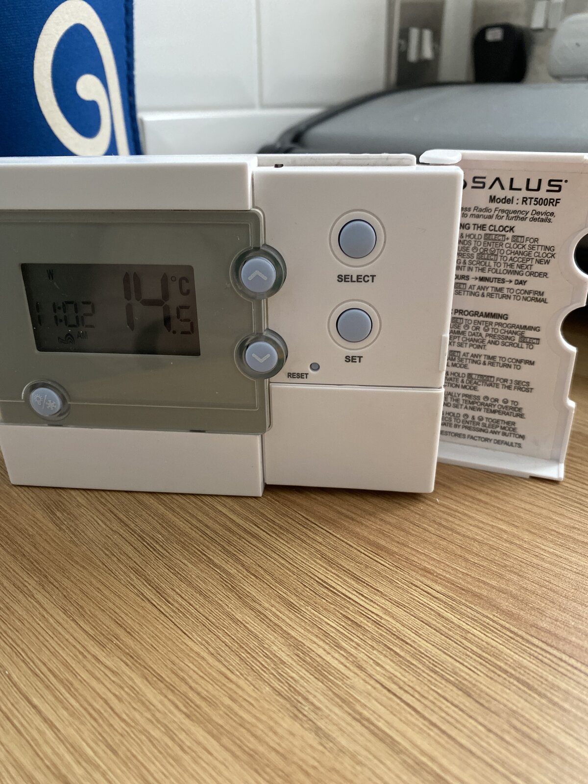

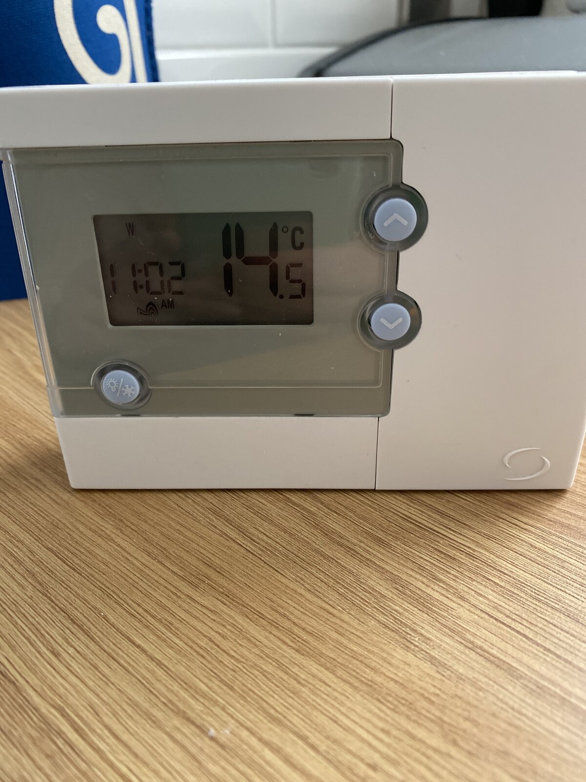

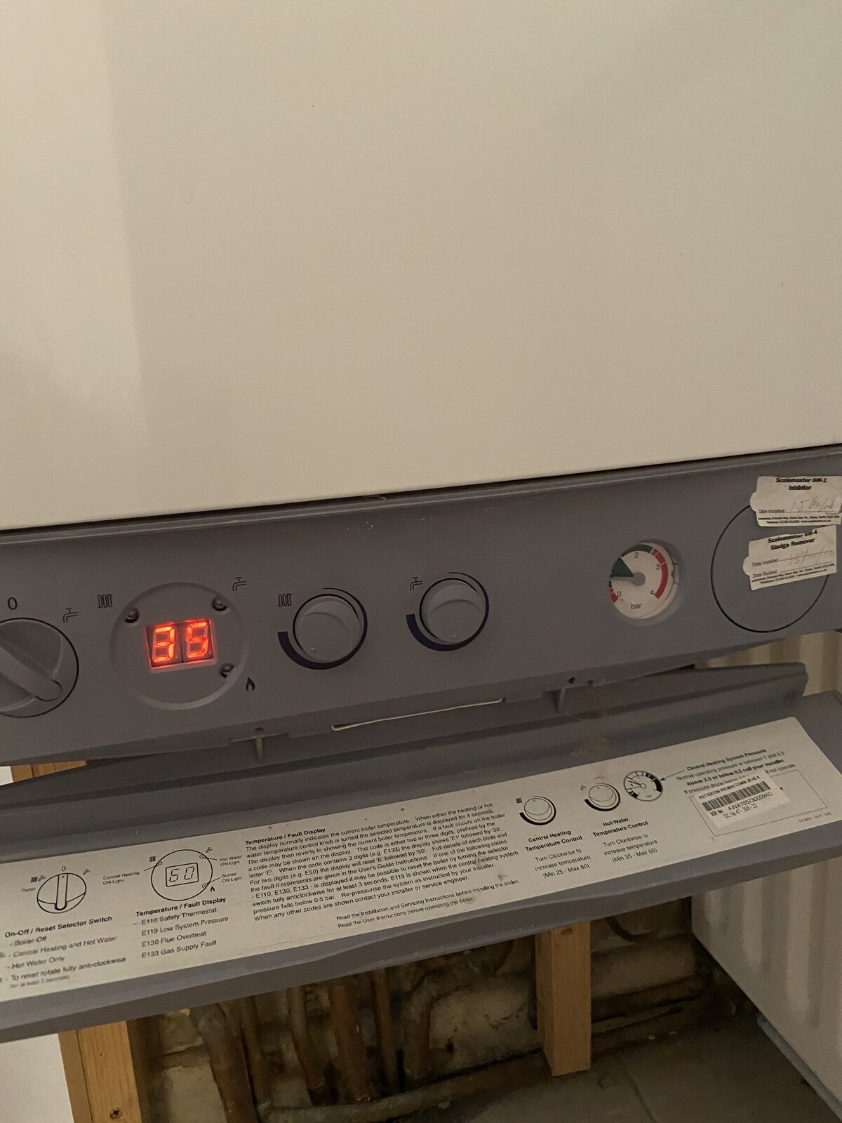

Hi there so last night the heating worked from 7-9 which is my only program that is working, still nothing on this morning and the override mode is also not working, this is the status at the moment

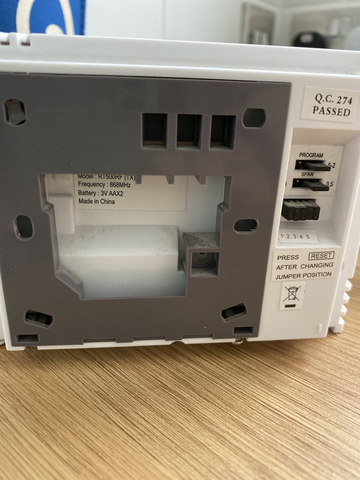

If you open the door on the handset, is it selected to once?

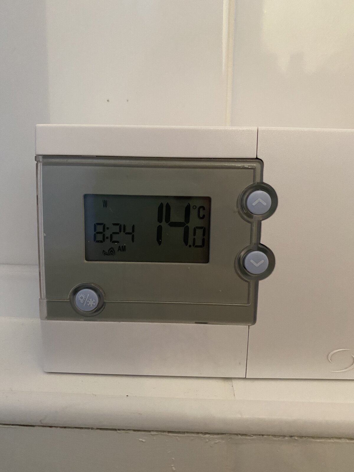

My thermostat looks like this
