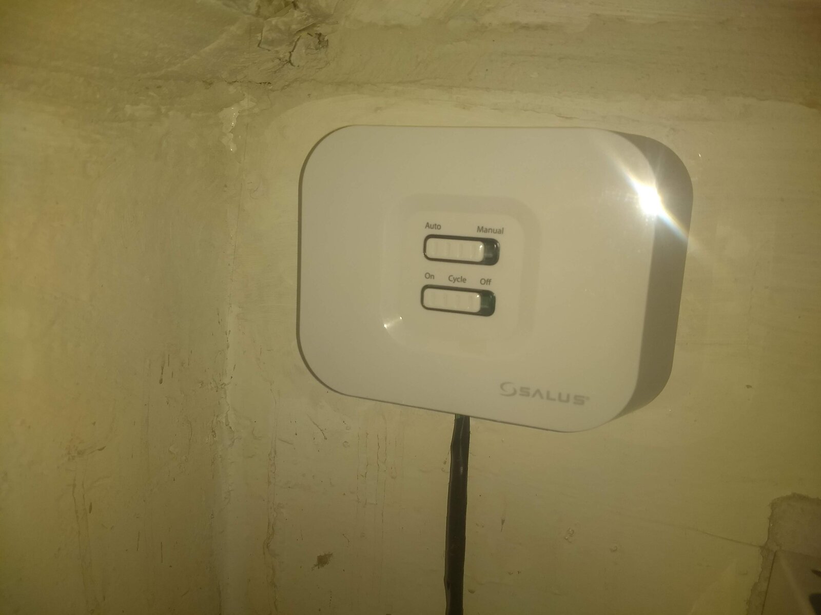

Hi there - wondering if anyone can help...
I've got a Salus wireless thermostat (ST620RF) which isn't working. The boiler is fine (at least, it's producing hot water).
When the thermostat calls for heat, the two LEDs on the receiver flick on and off (red and blue) in alternation, and there's a repeated clicking sound (which sounds like the click which you'd normally get when the receiver successfully switches to demand heat from the boiler). It sounds worrying like a relay switch repeatedly switching on/off.
I think the controller and receiver are paired successfully - the reciever has a steady green light, and will respond (with the problematic flicking on/off described above) when the thermostat calls for heat. The receiver will also produce the same problem when switched to manual with failsafe mode switched to on.
I've tried a reset of the reciever and controller, plus re-pairing (they seemed to repair successfully). And I've tried killing the power to the receiver for a bit before a reset/re-pair.
I suspect something is quite wrong with the reciever and there's not a lot I can do to resolve it... but any suggestions or ideas would be very welcome!
Thanks in advance.

Post a pic or which receiver you have , the box with the wires next to the boiler or post which one it is, there are more than one
Thank Ian - hopefully this helps?
... I think the model number is ST620RF - at least, that's what's on the instructions for both the control unit and the receiver unit on the all by the boiler. Thanks again.
If it doesnt come on setting it to manual, remove and put the two wires in NO and COM into the same terminal either one will do and the boiler will come on
put top selector to Man and the bottom one to on and boiler should now go on and off using the boilers onboard controls
Thanks a lot Ian. This just repeats the flicking on/off at the receiver unfortunately. That's what makes me think the relay in the receiver has died.

Is it worth taking the receiver off mains power i.e. disconnecting the L/N? It's connected to the same fused spur that the boiler's connected to (which doesn't seem ideal in the first place...) rather than to the boiler for power.
Guess I'm keen to avoid accidentally putting 230V through the boiler PCB where I shouldn't - but if I simply put the two wires connecting the reciever to the boiler into the same terminal on the receiver (either NO or COM), and leave the receiver connected to 230V as it is currently, I'm all good?
Cheers
yes disconnect and safely isolate the live supply to the receiver, it will stop the relays chattering
Thanks for the advice. Have removed the receiver from the mains altogether and just put the live and switched live connections to the boiler into the same terminal on the receiver back box ... all working ok. Need to get a new thermostat (and probably boiler) at some point but heating restored for now. Thanks!
