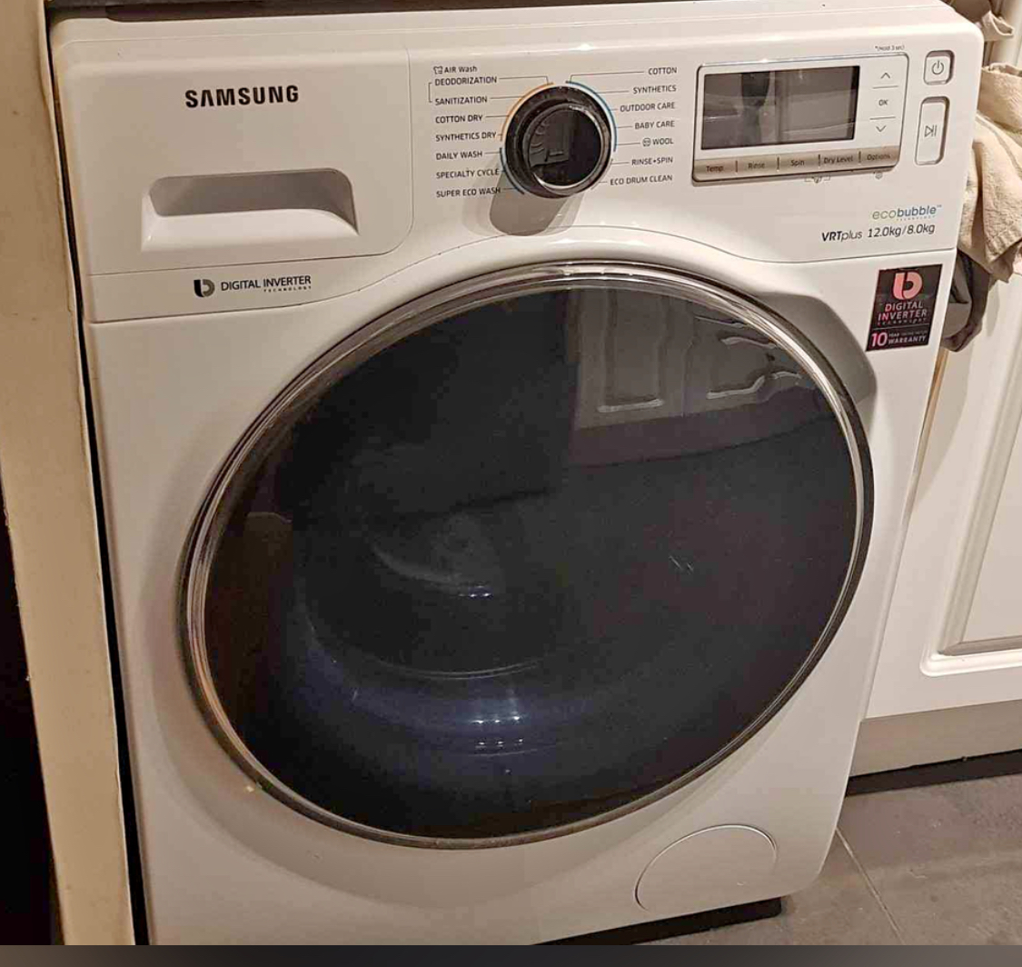

Samsung washer / dryer unable to switch on
Model number is WD12J8400GW
Ive now taken the top & rear cover off.
Cant see any circuit boards at the rear of the machine
With the plug removed from the mains I’ve held the on/off switch down for 5 seconds and then did the same for the play buttons. Plugged in & still nothing.
But I do hear a click when I switch on the mains. If I’m standing at the front of the machine the noise is left hand rear.
