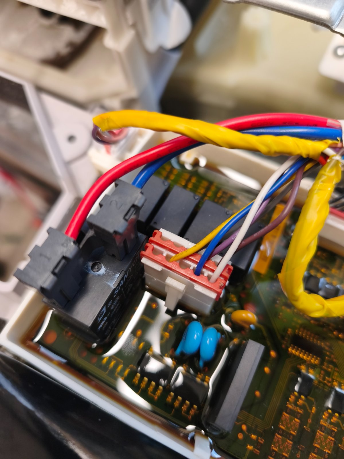

Also got live continuity at the this point on the power board at the number 2 connector (blue conductor).
There were 2 screws missing holding the panel in, but the machine has never been apart since it left the factory. ???
Just wondering what to do now, because I'm not trained in this stuff, if I buy a new board and it still doesn't work, I'm up the creek.
There's another connector on the other side of the board with thick white and blue conductors. The white has continuity with the neutral pin on the plug.
The blue does not have continuity with the live pin on the plug or the blue on the other connector in my last post.

The blue on the other connector (labelled number 2 in the photo does have continuity with the live pin on the plug.
I would expect the blue to perhaps be the negative, red to be the live. In which case, check both the live pin on the plug, for continuity, through to the terminal on the PCB, likewise check the negative through to the PCB.
Then your next test, would be to check that the 240v, is available at the actual pcb, once all plugged in, and the washer switched on.

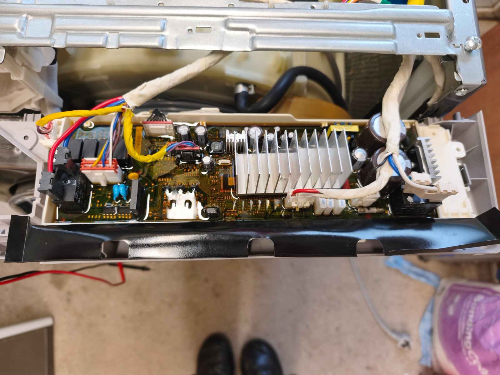

So, to summarise (see photo below), there is live (blue) coming in on the left hand side of the power module along with a red conductor, and neutral (white) coming in on the right hand side along with a blue conductor.
Now, rookie me took the blue and white on the RHS to be the power in from the noise filter, but the loom splits off where the filter is and goes down, so maybe that blue comes into the power module from somewhere else.
This is fast getting out of my league and I think it's a bit of a gamble for a rookie to splash out on a new power module to fix a 9 year old machine.
Don't want to throw good money after bad.
What say you?
I now think (although I can't pull the machine out to verify) that the blue on the RHS could be the live feed to the motor.
Could try and find a schematic, I suppose. But that still doesn't solve the "will replacing the power module fix the machine and if so, is it worth it for a 9 year old machine?" conundrum...
Only the thick red and blue wires appear relevant to me, the white wire appears to be a low power, or maybe control wires.
Thick wires, suggest they are the mains supply for the entire machine. To get the machine to work, it must have both the live, and the neutral appearing at the PCB.
Sorry, my wording misled you. By left and right, see below. I have circled the two pairs of thick conductors attached to the module.
The blue on the left has continuity with the live plug pin and the white on the right has continuity with the neutral plug pin.
