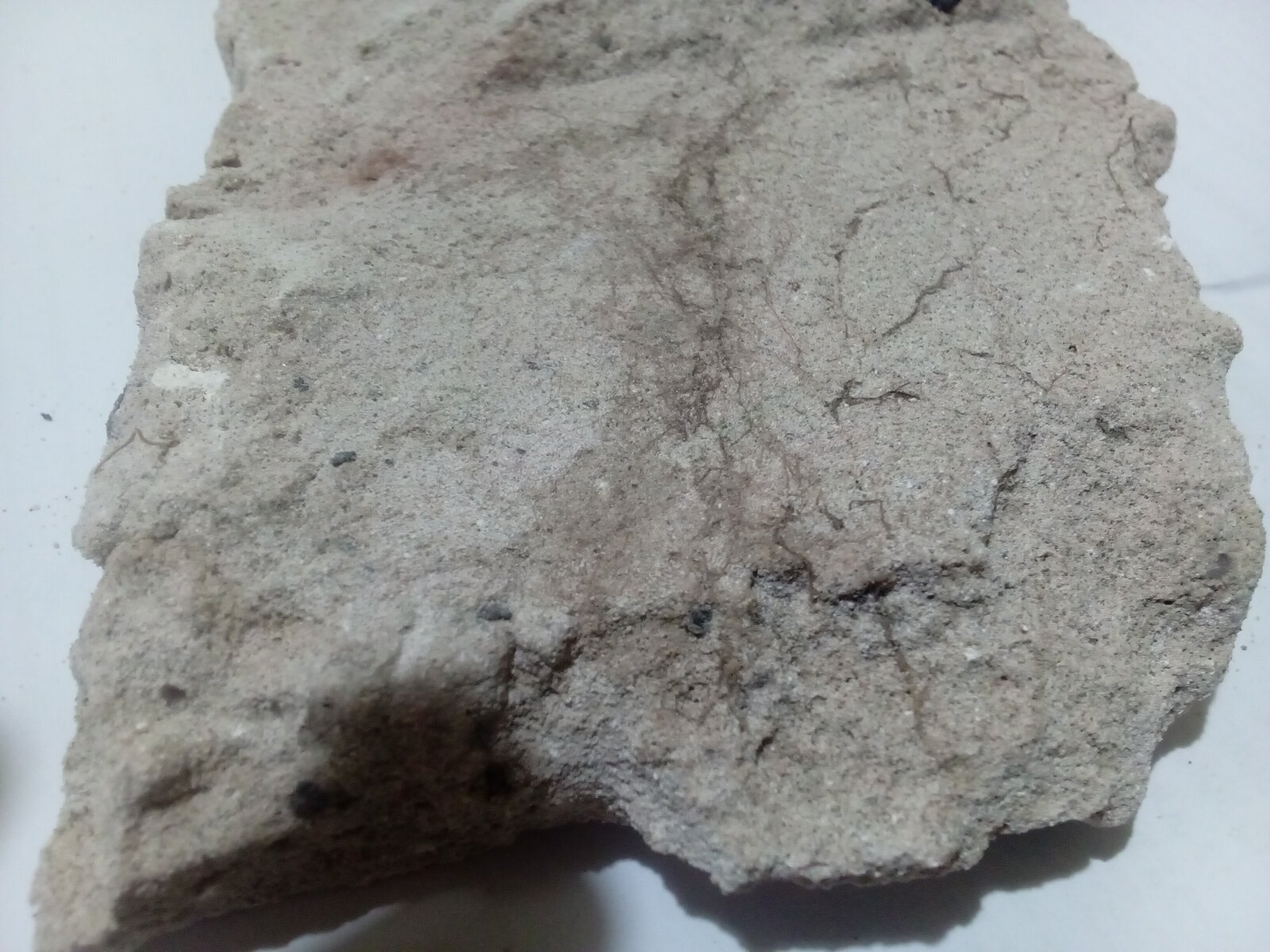

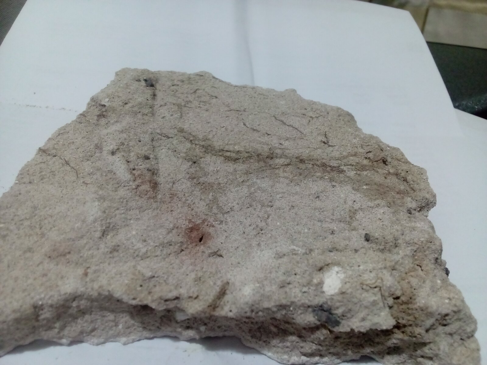

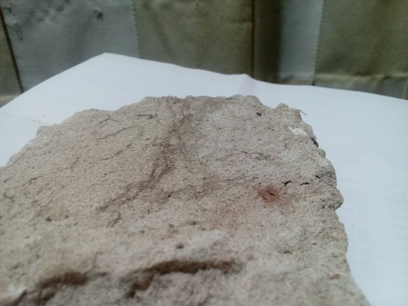

Just after a bit of advice regarding using Sand/Cement plaster on old brickwork.
I'm currently back to brick in my 1930's kitchen. It's a solid wall and i've been looking to have it plastered again. Most of the plastering companies I spoke to only offered dot and dabbing, which I didn't want. I've now found a plasterer ( recommended ) who says he will wet plaster with sand/cement. I've done a bit of reading on the net and I'm worried about this lime plaster issue, and it not being compatible with sand cement....cracking bricks, damp etc
Definitely looks like my original plaster is lime ( pics ) even though my house mortar is dark grey, cement looking. Am I worrying for nothing or is this a major thing ?

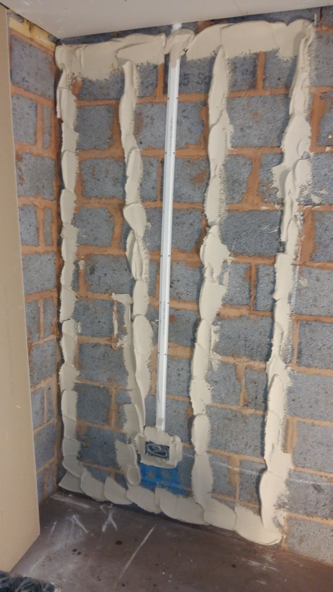

Correct dabbing format....

23, just to confirm,. You would simply dot and dab the insulated plasterboard straight to the brick wall and skim as normal ?
I'm thinking of just going with that and I can remove a skirting board a year down the line and see if it's wet.
They tend to need a few mechanical fixings in addition to the dabs.
You can also use foam to fix the boards on, with a few screws as well. Or screw timber battens on, which allow you to get everything level and plumb upfront.
