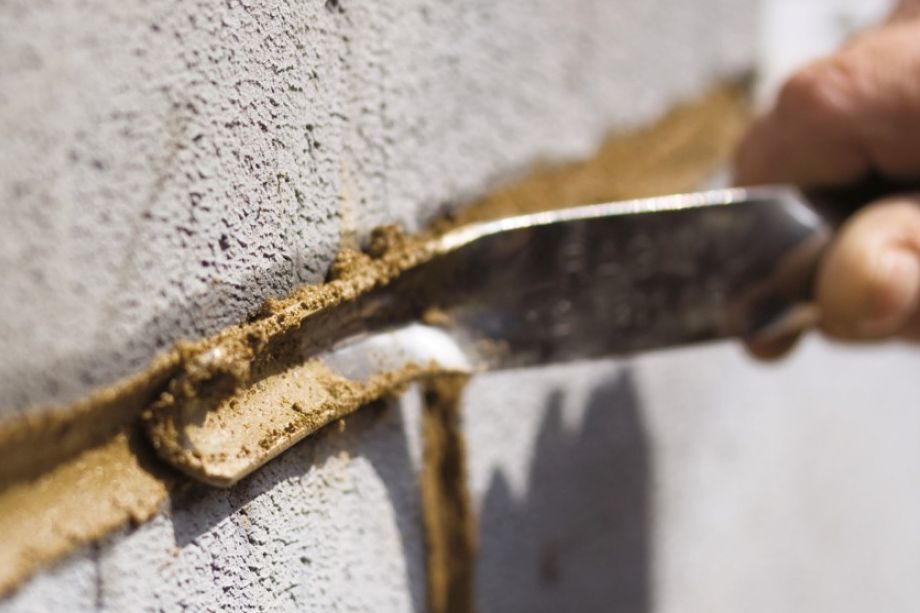

Ladies and Gentlemen , any idea how I can get this mixture ?
White cement and builder's sand?
Cement dye?
Lime and buidler's sand?

Experimenting needed, but start with yellow rather than red (more common) building sand
Can I use my Mastercrete grey cement ?
I would prefer not go to B&Q and drag a 25kg Snowcrete cement bag.
Just looks like a fairly typical yellow building sand mix to me, don’t think you need white cement

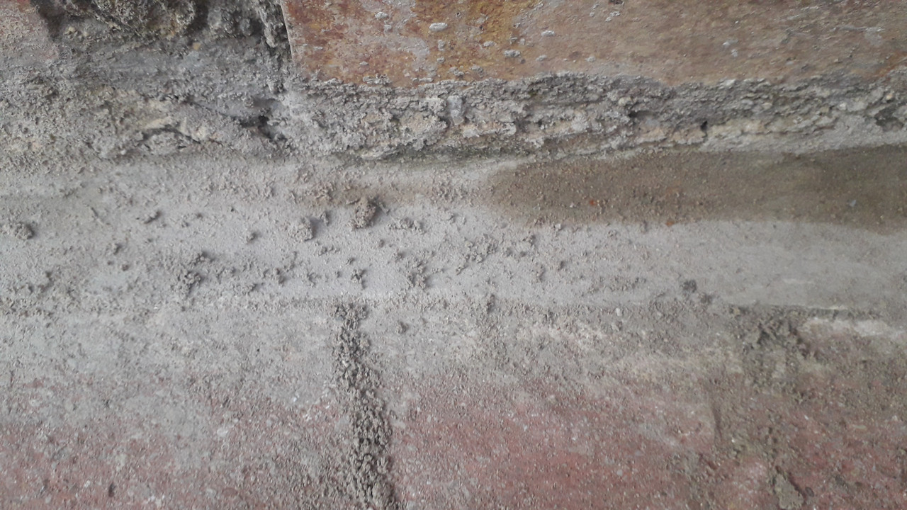

Thanks for the suggestions but this has not worked!
I have bought Play sand and mixed it with my cement but the mixture is still grey!
What I have and want :

I couldn't find builder's sand nearby ( out of stock ) so I had to go for play sand as it seems to be nearly the same thing.

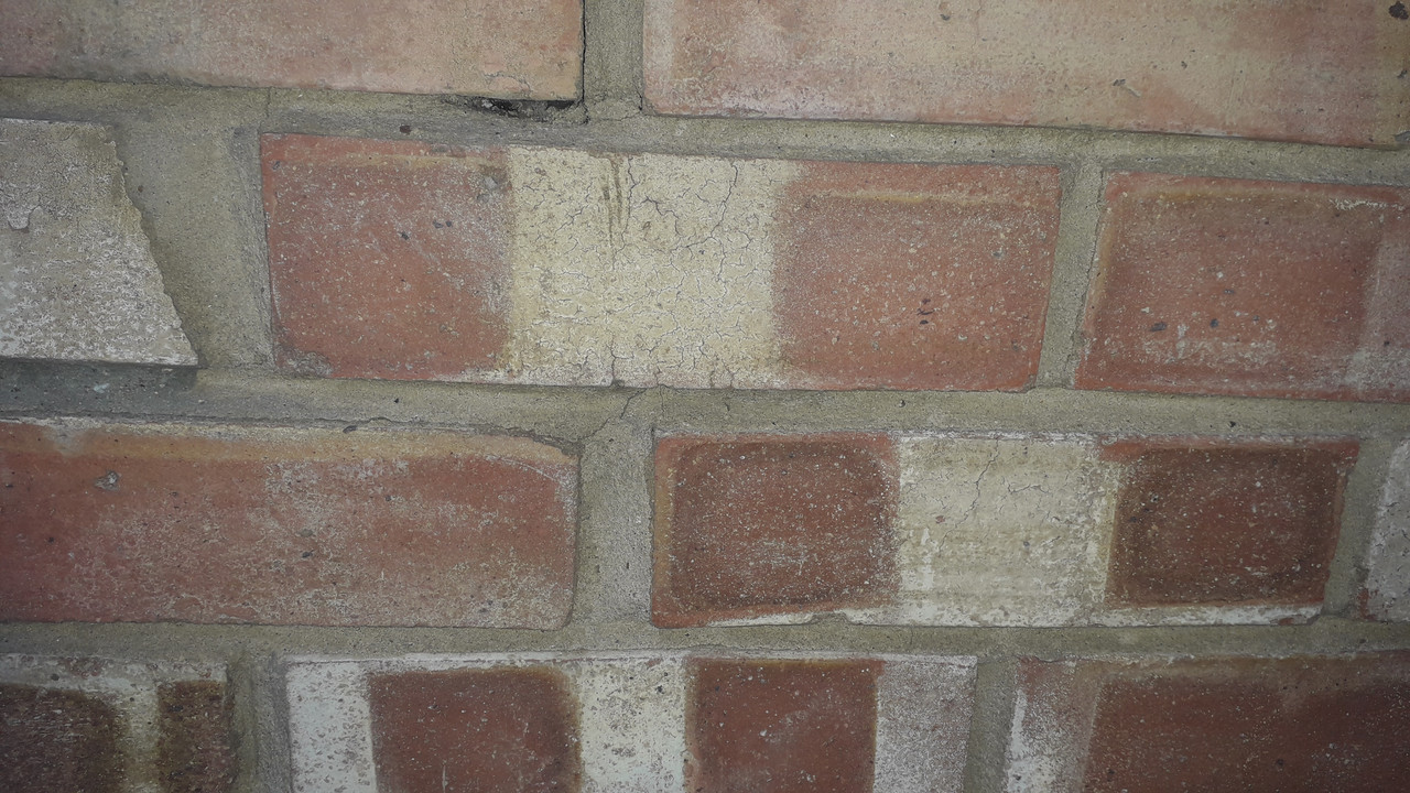

My question remains - how do I get the sand coloured shade in between the bricks.
To put into context, the builder in the past did that bricklaying and the mortar is not level with the bricks. Hence, there are cracks , some mortar has broken off while rest have ants setting up nests!
I ended up using yesterday's mortar mix at the bottom , where the wall meets the floor tiles. The picture is before the mortar dried and before I cleaned up.

The one in my last post, Sir.
I think the camera does not correctly capture the actual colour. But, it looks sand coloured.
You need an iPhone then ;)
The only way to match the colour is trial and error. I’d buy at least a bag of normal building sand and go from there. yellow building sand, which may be slightly harder to get, will give you a lighter more yellow colour. But it also depends on things like how porous the bricks are, so you’ve really gotta do small test trial patches.
