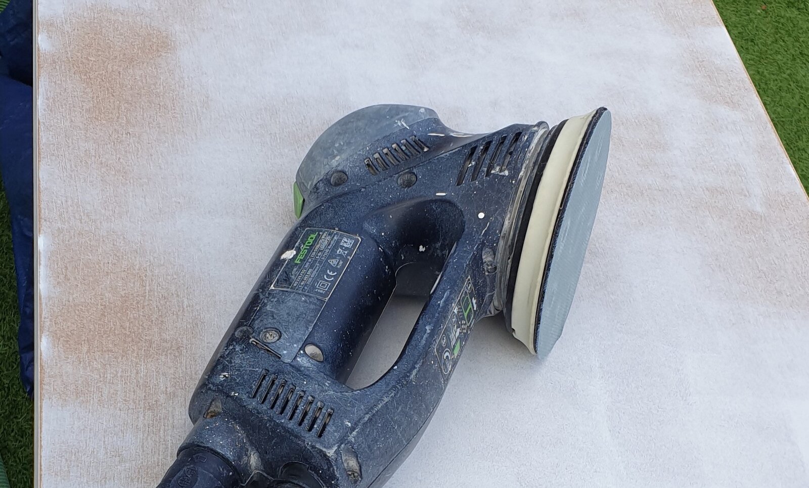

The first coat however does require sanding, particularly if painting something like MDF. When priming MDF, I sand back a hellava lot of the primer off. MDF is not as flat as the manufacturers would have you believe. Other than the fibre grain, the sheets have parallel sanding marks. I guess they run the stuff through massive drum sanders.
This site compresses images, hopefully the cropped image will let people see the drum sander score marks to the right of the sander. In the image I used Leyland Trade acrylic primer. It is the only acrylic primer that I have used that is a dream to sand. Most other acrylic primers clog my abrasives.
