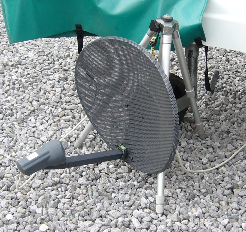

I'd second the suggestion that the dish needs not be mounted high up... Here's a pic of my caravan setup:
