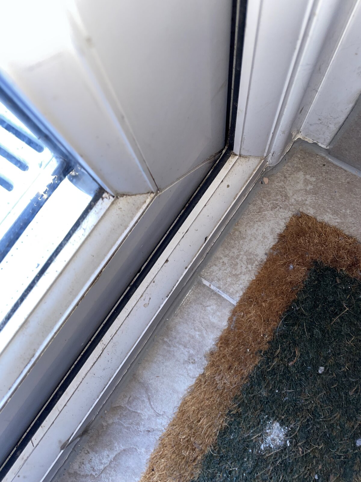

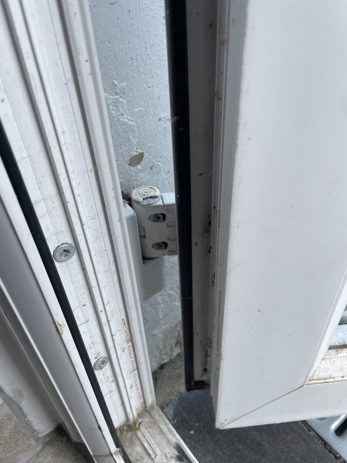

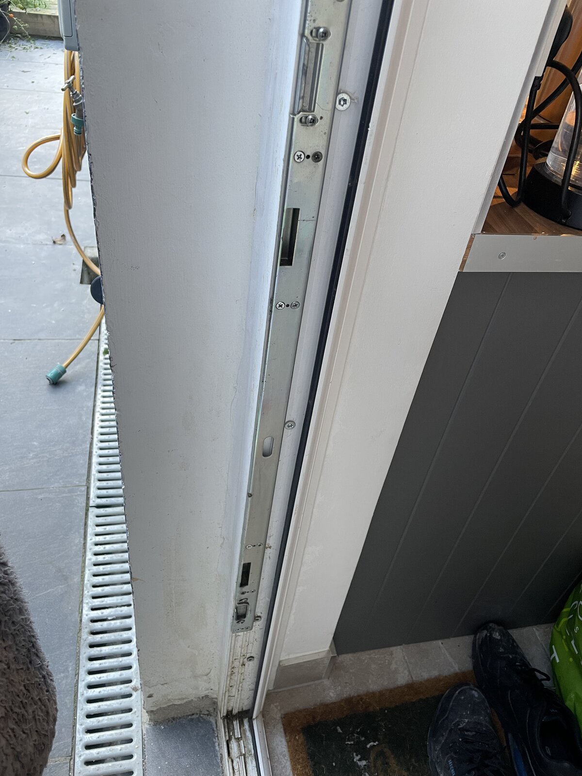

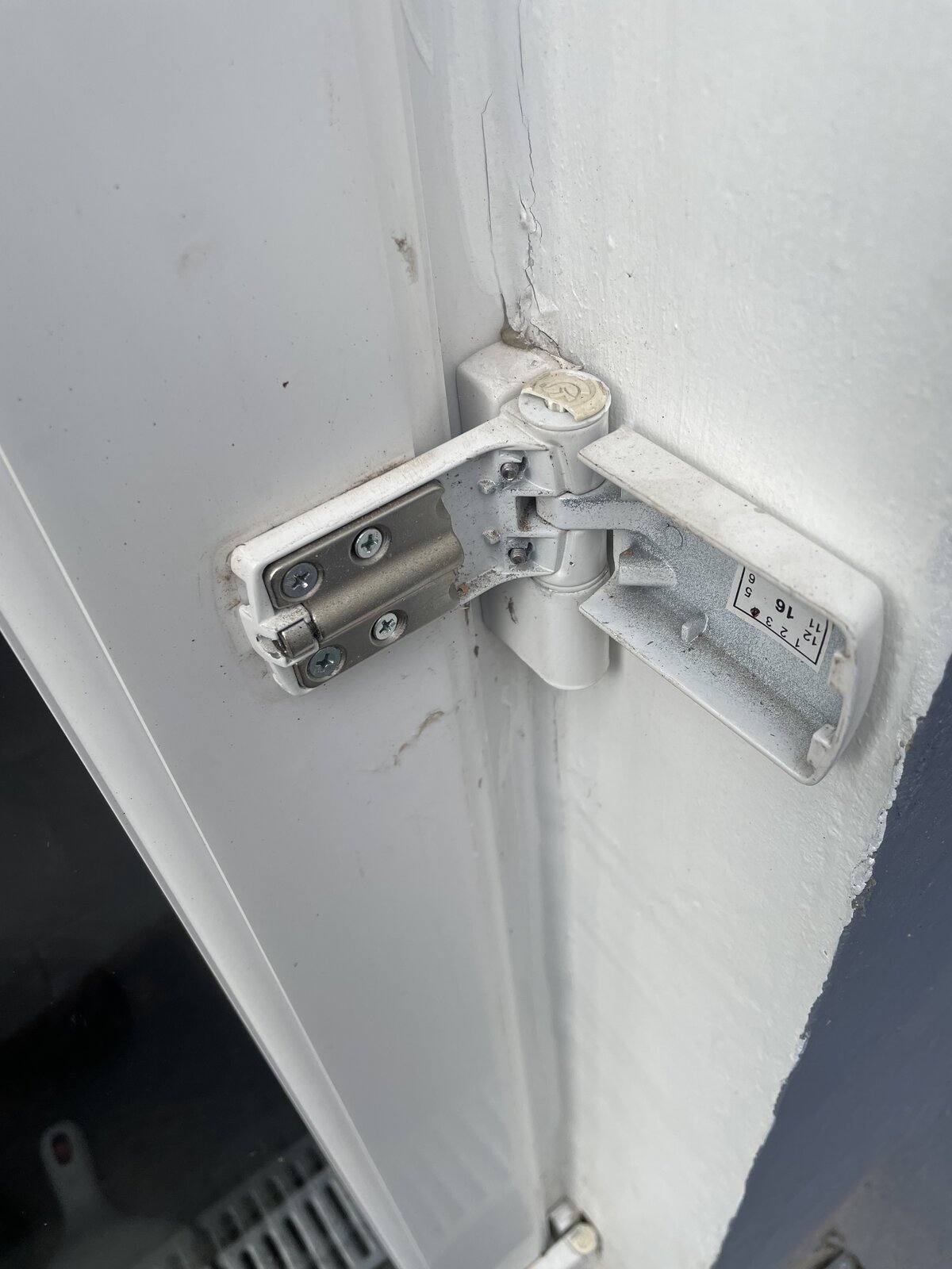

UPVC door is sealed at the top, but leaves a large gap at the bottom. I can’t for the life of me figure out what else to fiddle around with.

Look on the corresponding spots on the door leaf and see if there are adjustments there. If it's a manufacturing defect, then your are out of options on the adjustments.
Alternate solutions that will work to some extent are:
Stick on door leaf to close the gap.

Im guessing you are pulling the handle up to engage the locking mechanism when you can see the gaps at the bottom ? Manufacturers will tell you a door isn't airtight/watertight until all locking points are engaged ( hence pulling the handle up ) .
