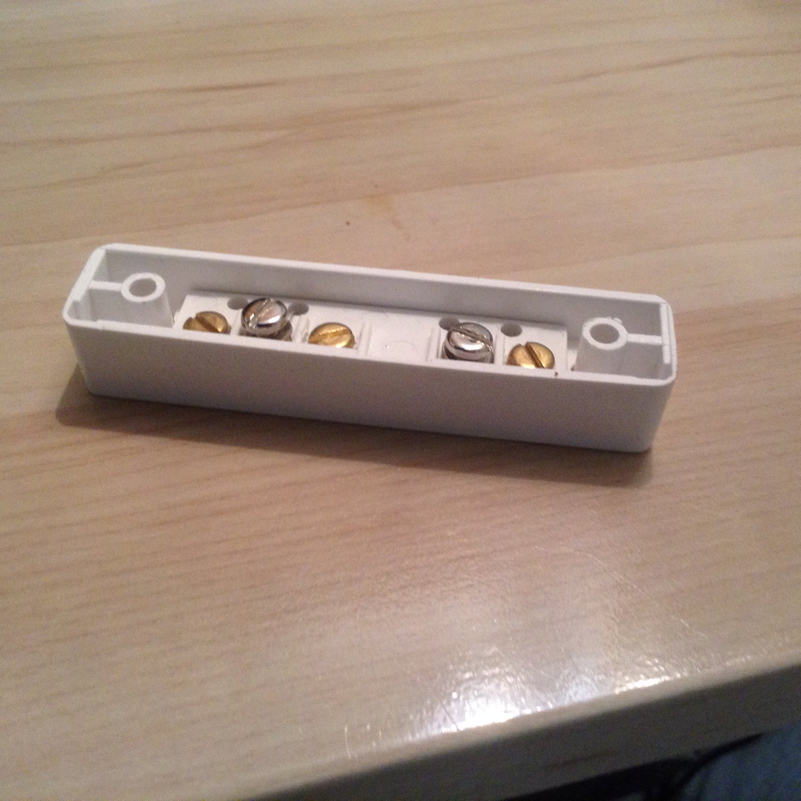

If you have changed the contact have you connected it correctly ?
Possible faulty cable to door ?
Link out zone 1 and if sets ok then one of the above
Post photo of door contact with wires connected
Twist blue and yellow together at door
If alarm set's ok then fault contact or wired incorrectly
This it it m8
The silver terminals are the contact
Twist wires together at the door that will prove fault ?
