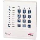

Hi guys
i have a worn keypad. There are two types of 9427. Are they interchangeable?
or another option ?
if anyone has the blue one in old stock id be happy to do a deal..
thanks in advance.

Just fit the newer version…or take the old one apart and clean keypad mat and carbon tracks ( meths and a cotton bud )
Thanks sparkymarka - systems been fine since you sent me a transformer
i have taken it apart and cleaned it even changed the code to previously unused pads, but its started to play up again.
ill give it one more try and if that doesnt fix it i,ll replace with the newer model if its a straight swop.
I’ve had my monies worth after 20+ years, so may be time to get a new one, but i dont want the hassle of rewiring and not to enamored with wireless.
