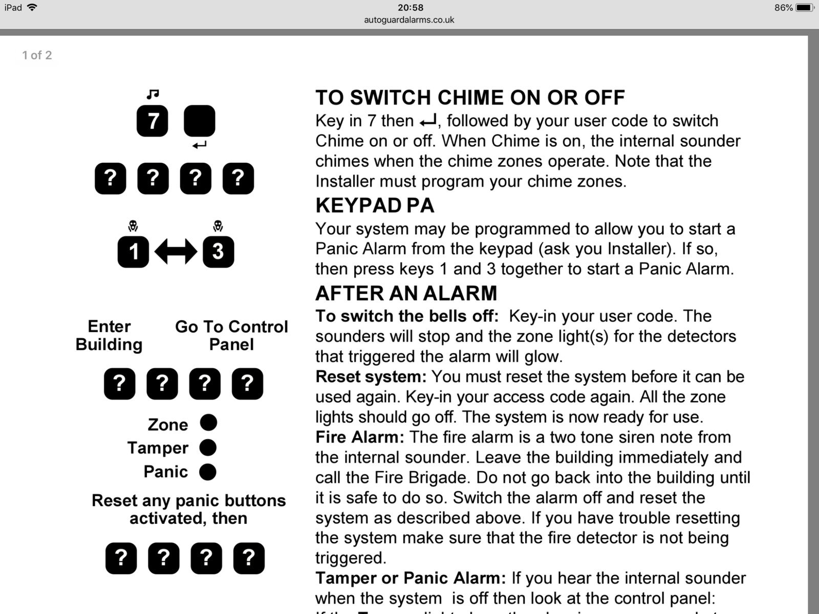

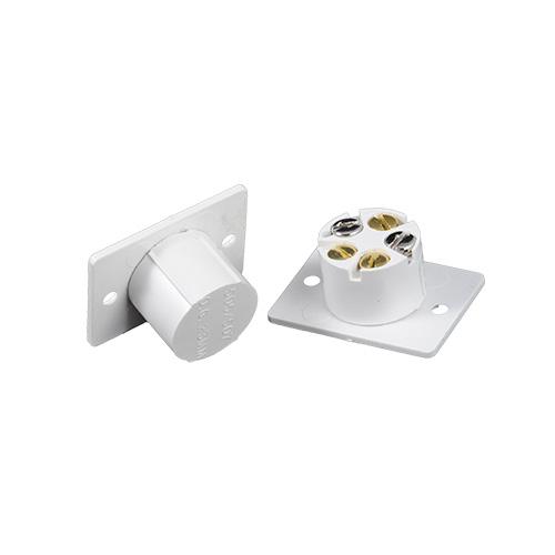

I have changed the front door magnetic switch. I've wired it in and now I got no tamper alarm (which is good) however, there is no chime happening either when opening the door. I have set the chime setting to zone 7 (Entry/Exit) in the engineers section as per the user manual.
I have checked the reed switch using an LED and a 9v battery and magnet. The LED does come on when a magnet is close so the reed switch is working perfectly. I just don't get why there isn't a chime coming from the control panel when the door is opened. I have the front door wired into the EE contact on the panel and the global tamper in place as per the example wiring on page 21 (Fig 19) of the installation and programming manual I downloaded.
Any ideas at all? Tomorrow (Saturday) I'm gonna test for any breaks in the wiring.
Thanks in advance.
A3DA7A31-F57C-4556-BF25-A6410F790A6A.png No ... you have set chime zones in engineering ....now you need to activate chime from user ....
ok I have set the chime from the user. I haven't yet tested it out as it's late so I will try it out tomorrow.
I did an alarm test earlier and when I opened the door it didn't start any countdown there was no sound at all, but when I triggered the PIR I have set up the internal alarm sounded as expected. However, there was nothing when I opened the door.
Thanks,
Hi All,
Have tried the door again but still no chime from the system when the door is opened. Checked the wiring by putting an LED on the end of the wires in the control panel and applying power from 9v battery from the door end. LED comes on so no breaks in the cable. Not being detected on a walk test either. It's a flush mount door contact (swapped it like for like).
I don't see what the problem could be?
Any help appreciated.
