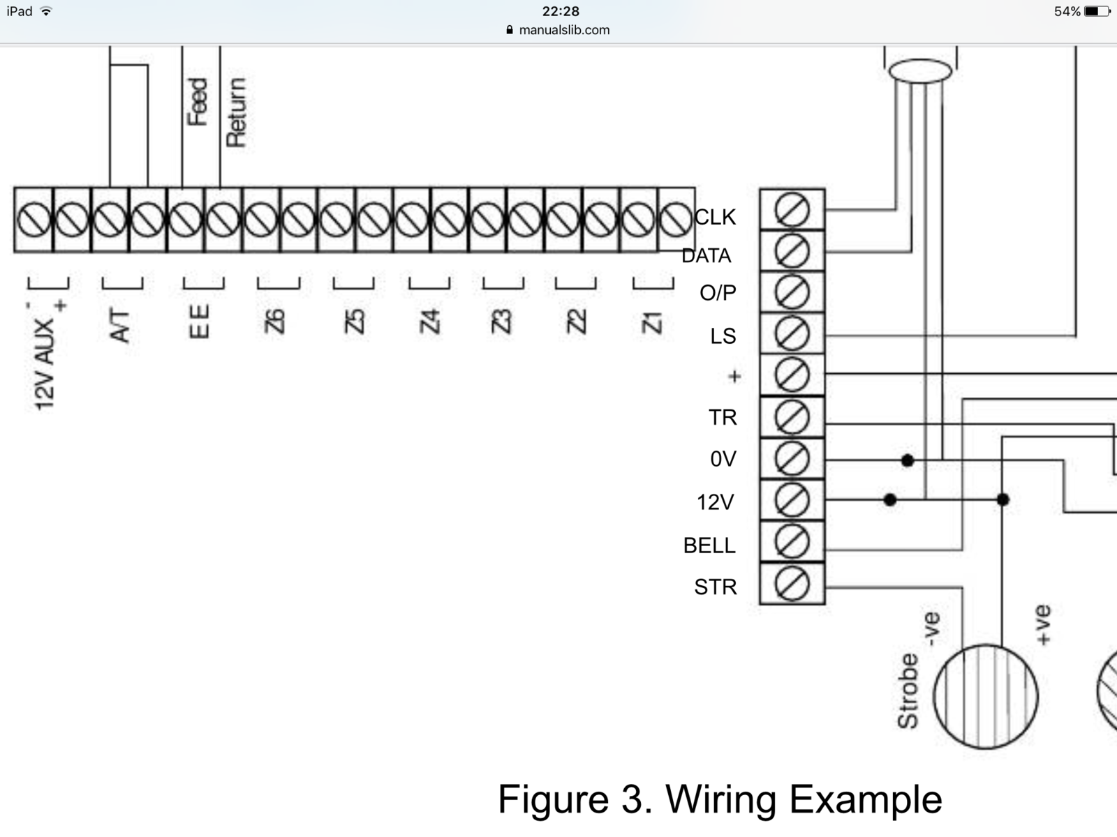

When you reconnected the keypad , did you get the clock and data wires correct ?
Hi SparkyMark A
I am sure that I got the wires to Data and Clk the right way round as I double checked before I applied the 12V supply.
If I did have them back to front would I have caused any damage ?

You need to remove the fuses in the main panel on the pcb they are all low voltage 12dc or 17ac transformer input ,check voltage at aux 12v/0v and bell 12v/0v

Ok all above seems fine , check clock and data wire to rkp and also check that the rkp address link in the keypad has not fallen off..
