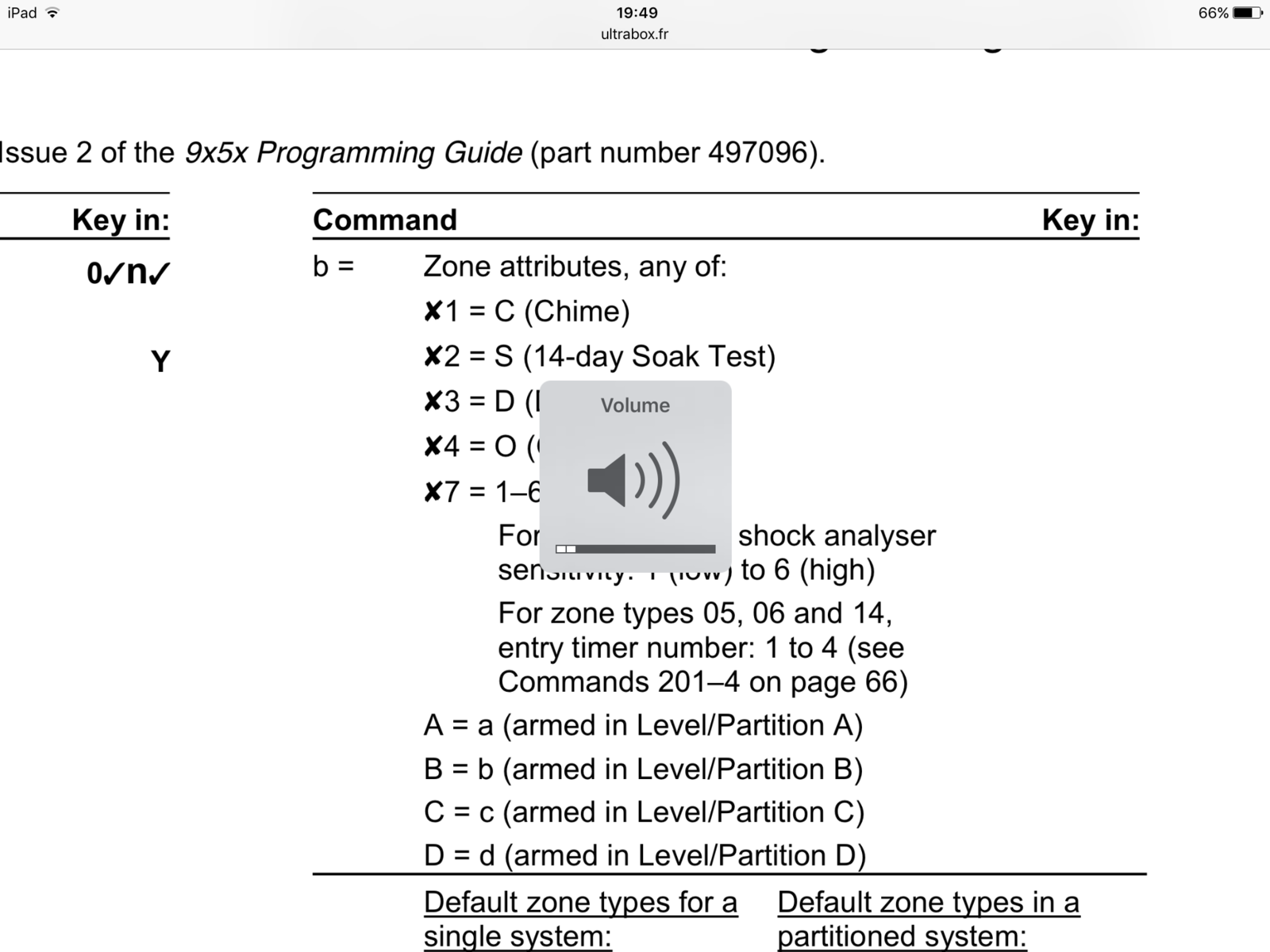

Hi, when I view a zone properties on the keypad for a zone it displays: 'c' and '1'
Any ideas what they mean?
Thanks-
Thanks very much!!!

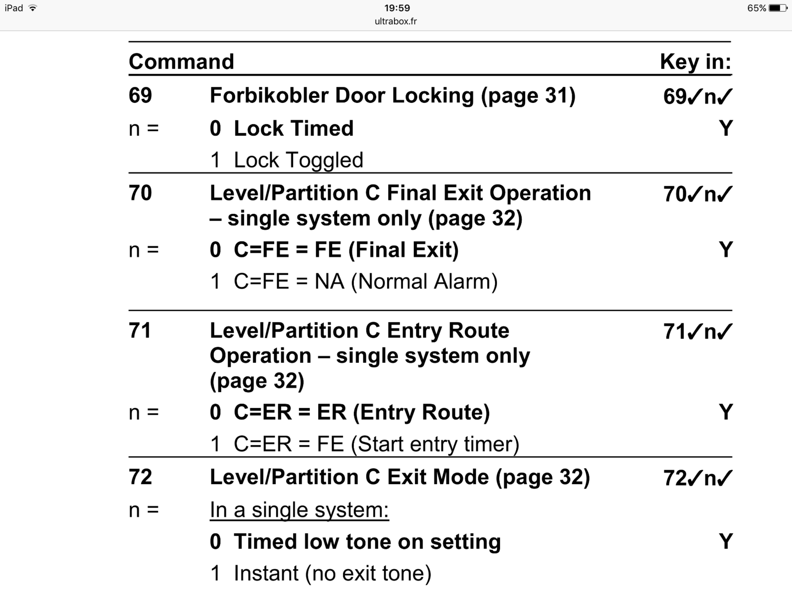

I have a zone which is ER in all sets and I'd like to make it sound immediately in B & C set.
Any thoughts?
Option 61 and 71 leave as ER
thank you sparkymarka
Is this correct: 61 (tick) 0 (tick)
