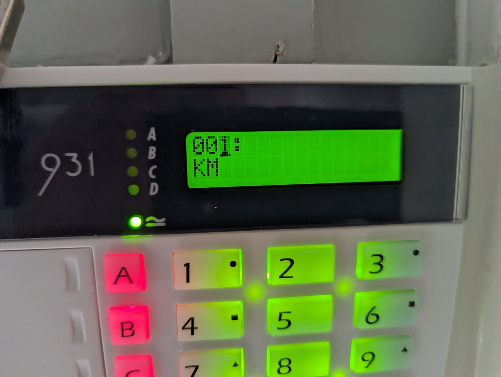

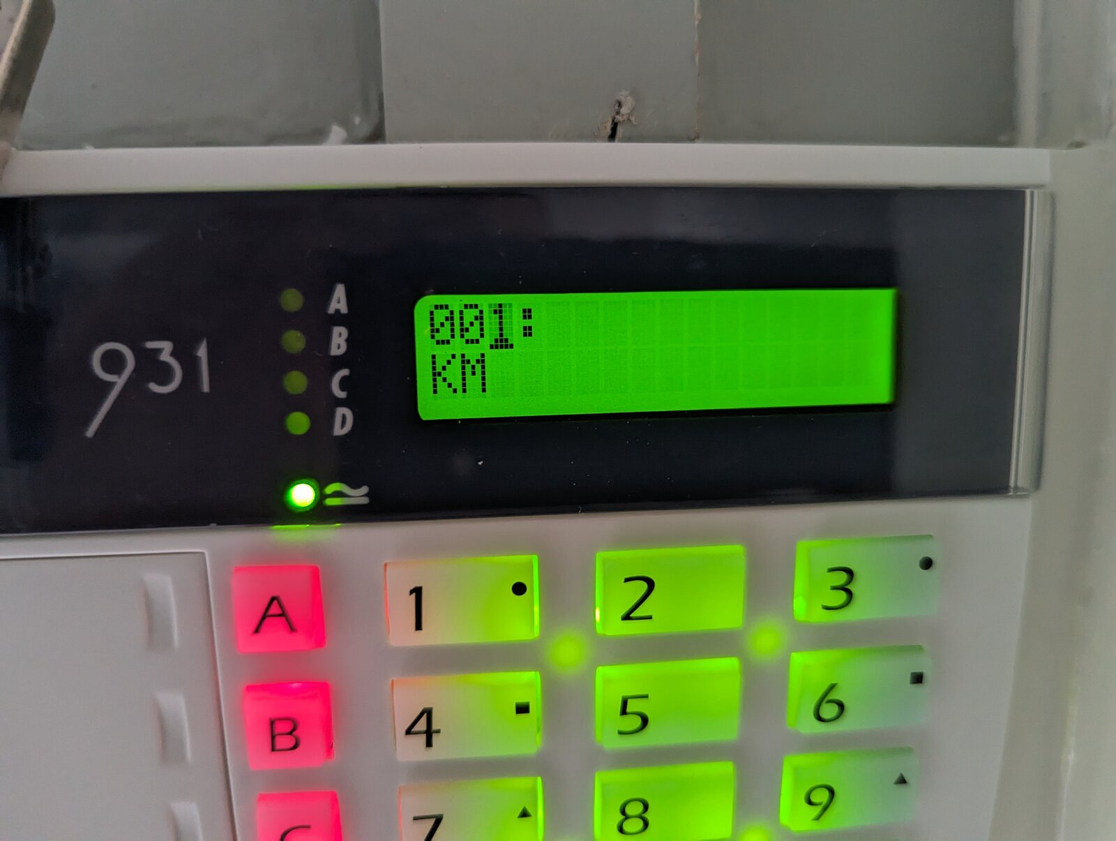

Yup. Problem is though, my alarm system doesn't seem to do anything when the zone in in KM mode, and I open/close the zone circuit.
This is how it looks on the keypad when configuring zone 1.
I'm simply connecting the circuit together using a wire between the two terminals to simulate a key switch/relay
U00:A03:RESET
U00:A02:RESET
U00:OFF SITE
Is the latest in the log for today when I touched the wires.
Alarm zone 1 on the main board.

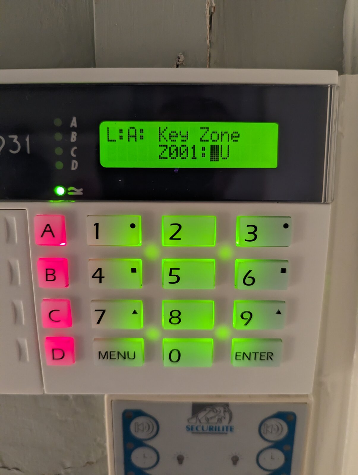

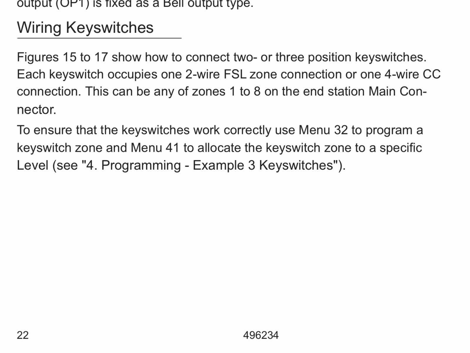

Thanks, my model is 8136 which doesn't have this bit in the manual.

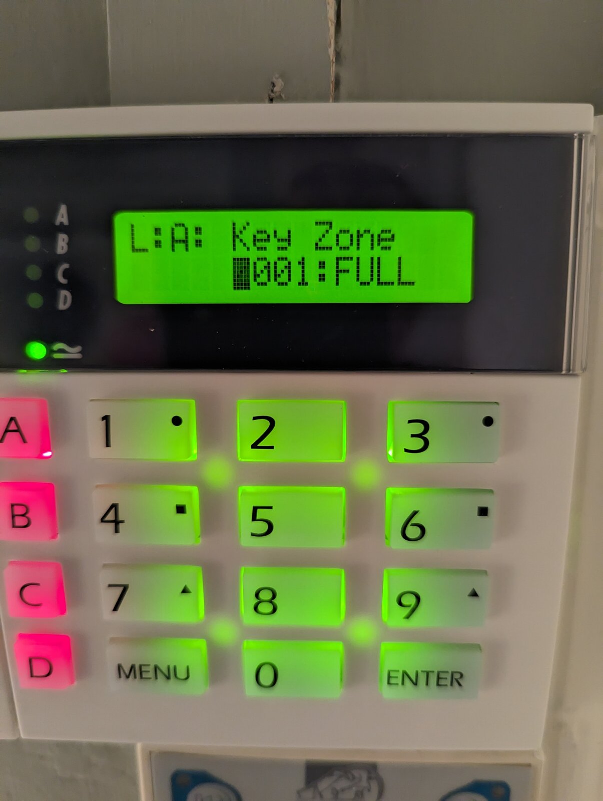

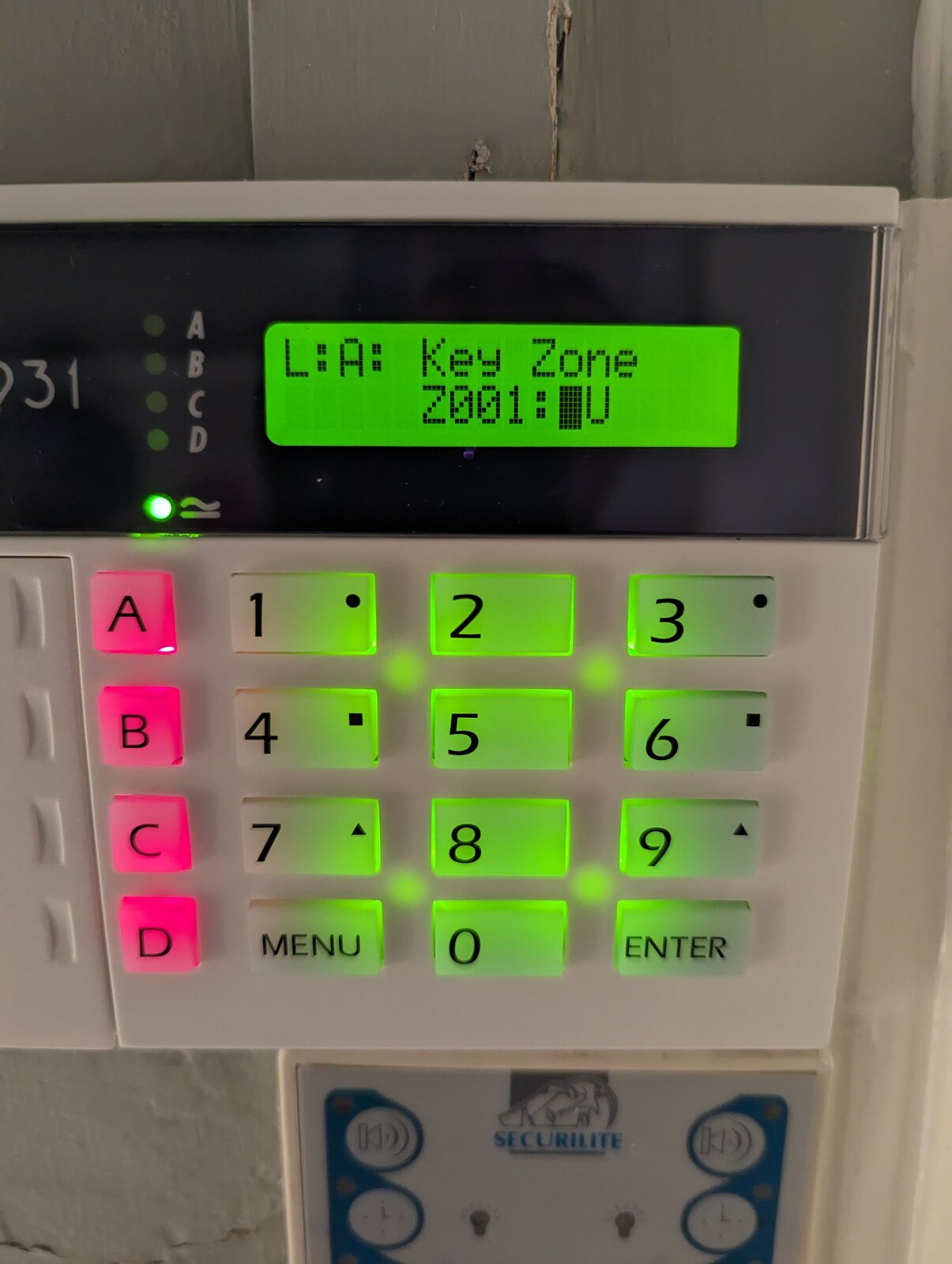

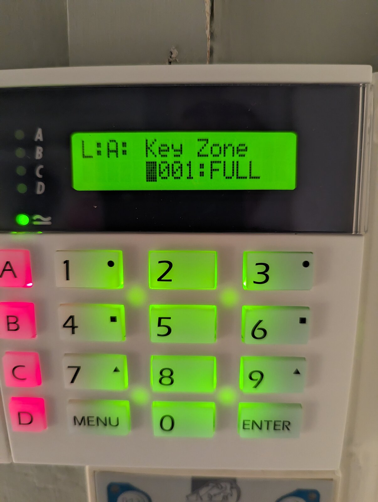

The KM doesn't seem to exist in an area (see the photo above where I configure the zone). however, I do have a keyzone setting on the levels now (I think this is new). See attached :)
