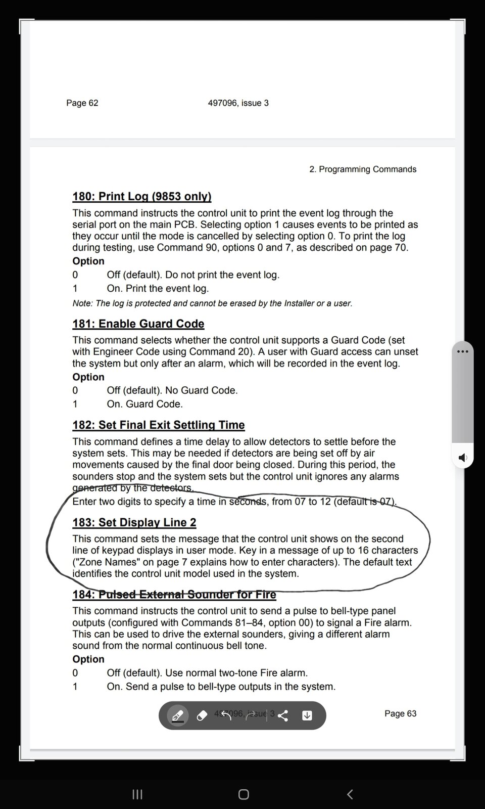

Hi does anyone know how to change the name that is currently on the keypad
Screenshot_20220807-095052_Samsung capture.jpgThis should help.
