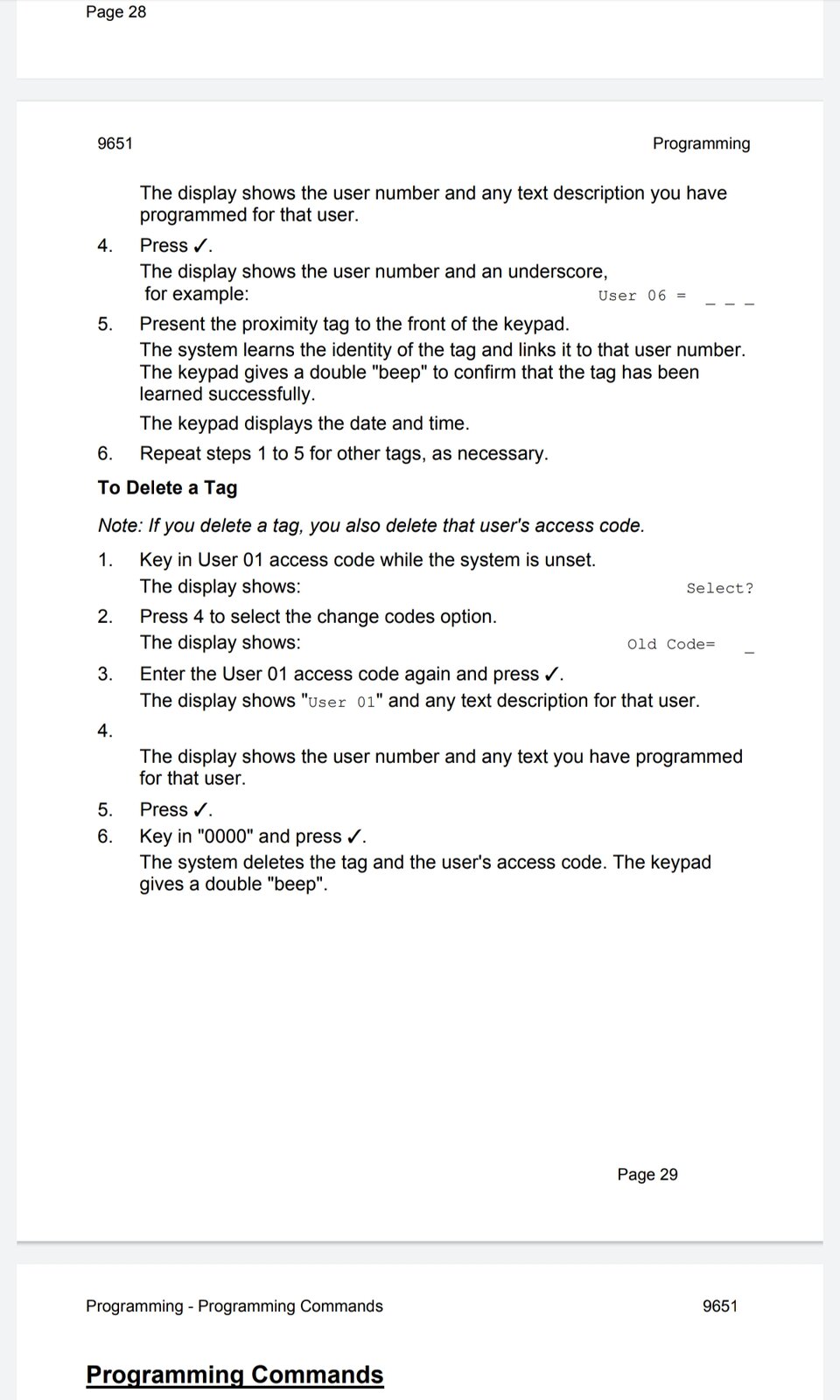

Hi
Does anyone know how to remove an existing tag off a scantronic alarm
They need to remove all the existing tags. Someone told me to go into engineer then option 4
Go in and delete each user slot up to 16 by changing the code to 0000 in each slot ….eg master code **** 4 ….x002 , 0000
