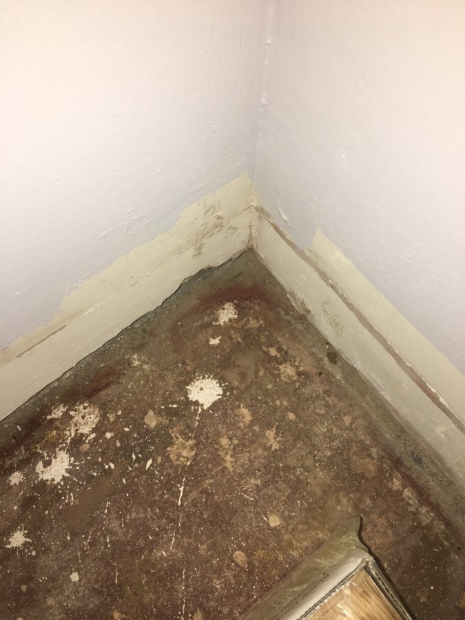

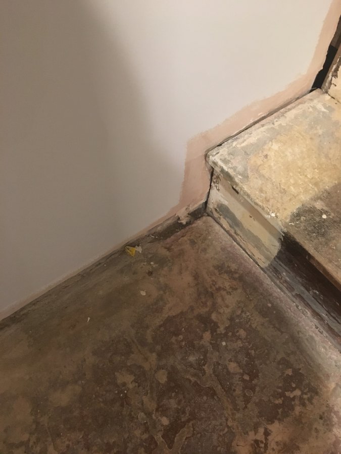

If the smell i coming from the corners where it's still damp, then that needs to be treated first.

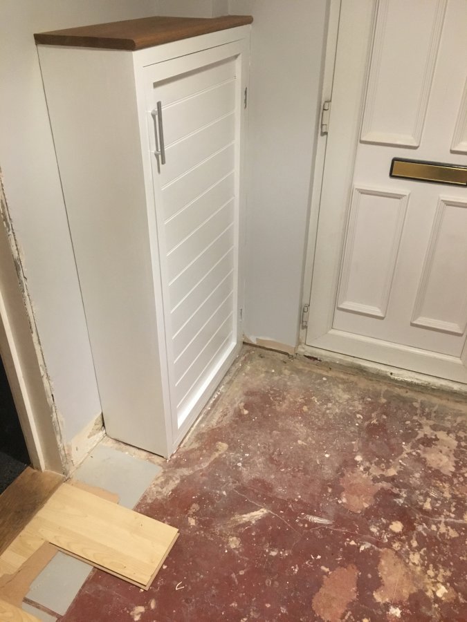

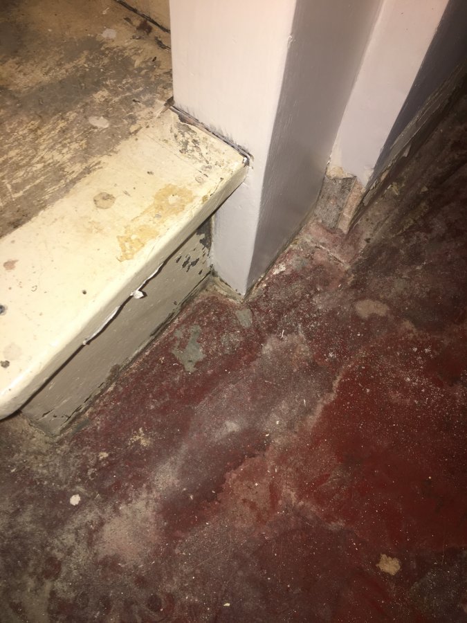

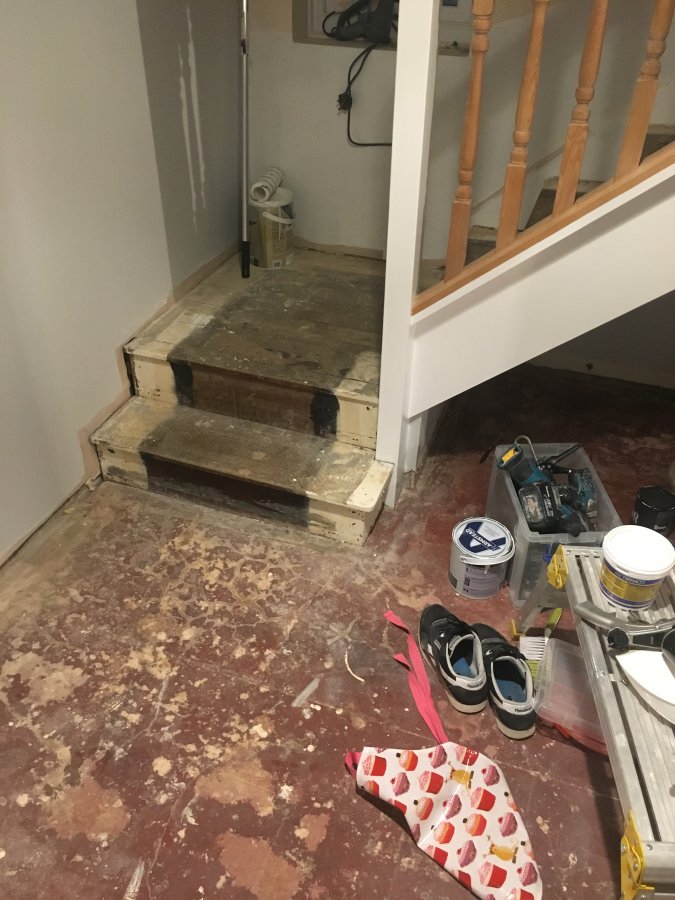

Sure, the gaps are not very big and kinda hard to see on a pic. if I disturb the corners it smells but left alone there's no smell.

All the skirting is already off in those pics, I'm fitting 167mm skirting so I just haven't painted that far down.
That sounds like a plan tho I'm gonna have to screed as I'm laying engineered oak boards on top and the current floor level is way out, it's like they dumped all the material in the middle and pushed it out to the edges leaving a bowl.
Cheers Sean
Liquid dpm - screed - laminate dpm - underlay - boards
