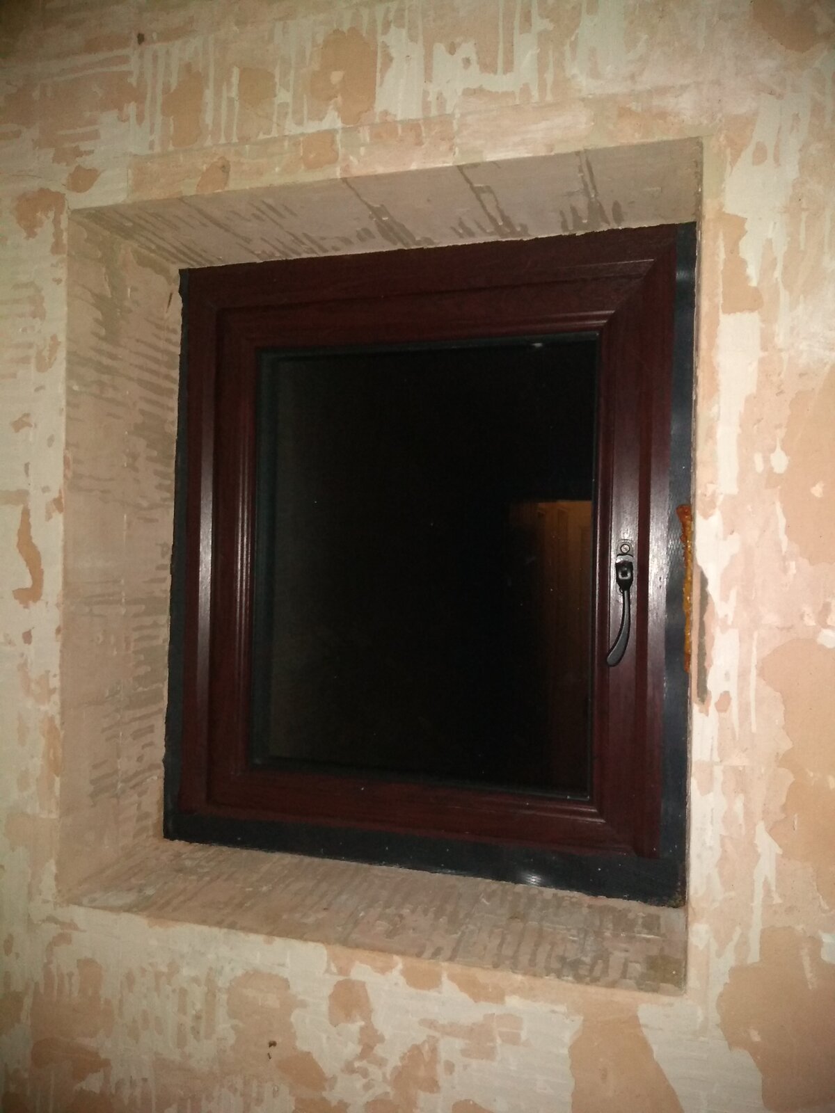

There's a small uPVC window in my bathroom which is a little bit loose. The whole window (including frame) has movement within the opening.
Some of the other windows in the house have screws going through the frames and into the sides of the walls in the reveal. So I'm presuming I can do the same here to make it solid.
Does anyone have any tips as to what screws to use and how to go about it please?

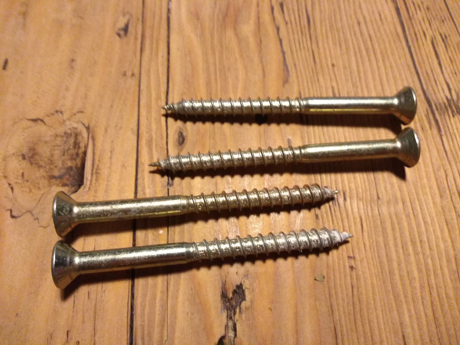

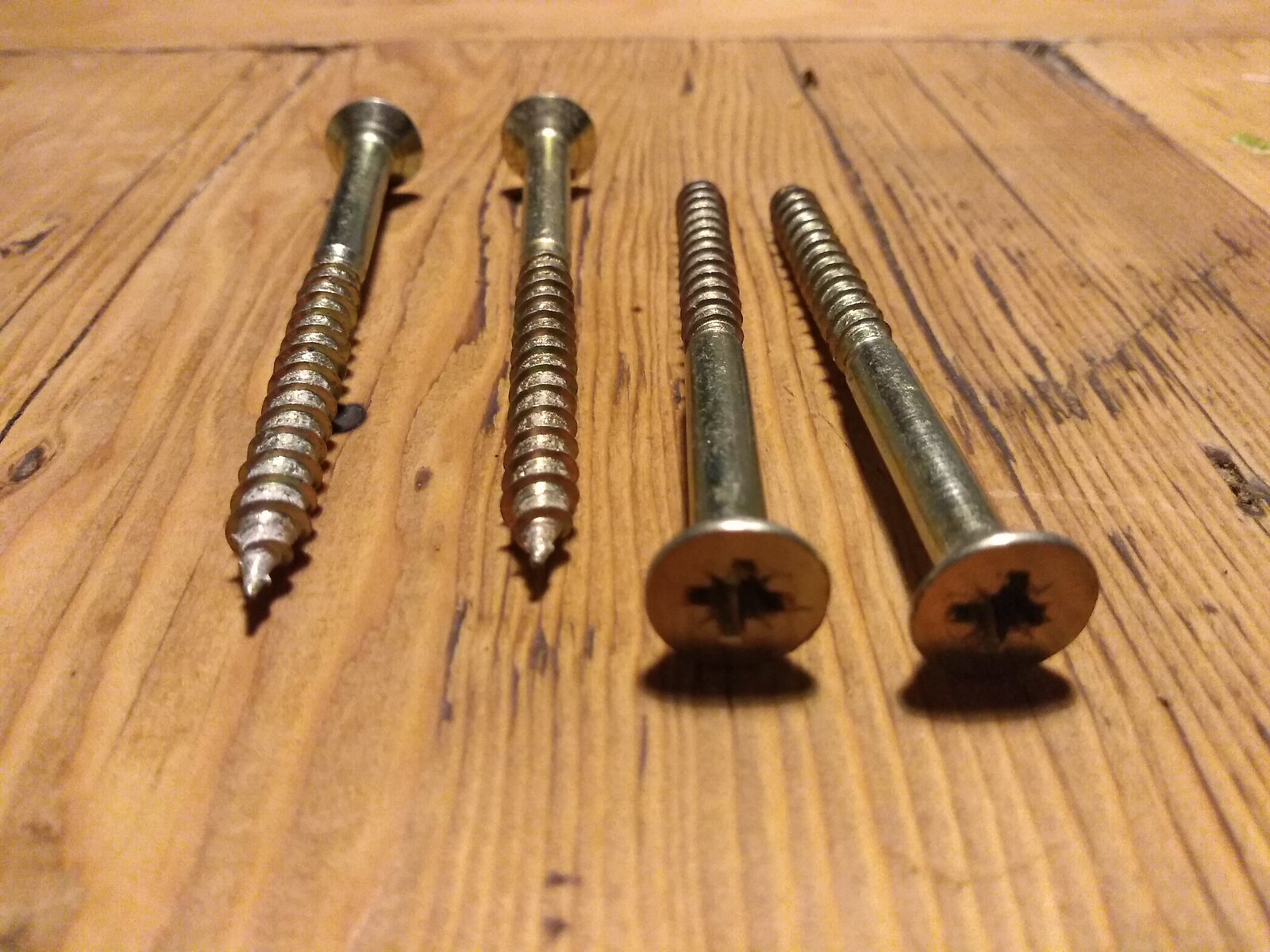

I've just been having a rummage and I found these... Are they concrete screws? Can you tell from a photo or any other way to tell if not?
Sorry to be such a DIY dunce!
Are the previous fixings loose, or aren’t there any?
if there aren’t any Masonry frame fixings would probably be your best bet, guessing around 110mm long.
There aren't any fixings in this one. Strange because other windows in the house do have them but this one doesn't. And it sees a lot of weather from the west (quite elevated in the Brecon Beacons). Thanks for the suggestions.

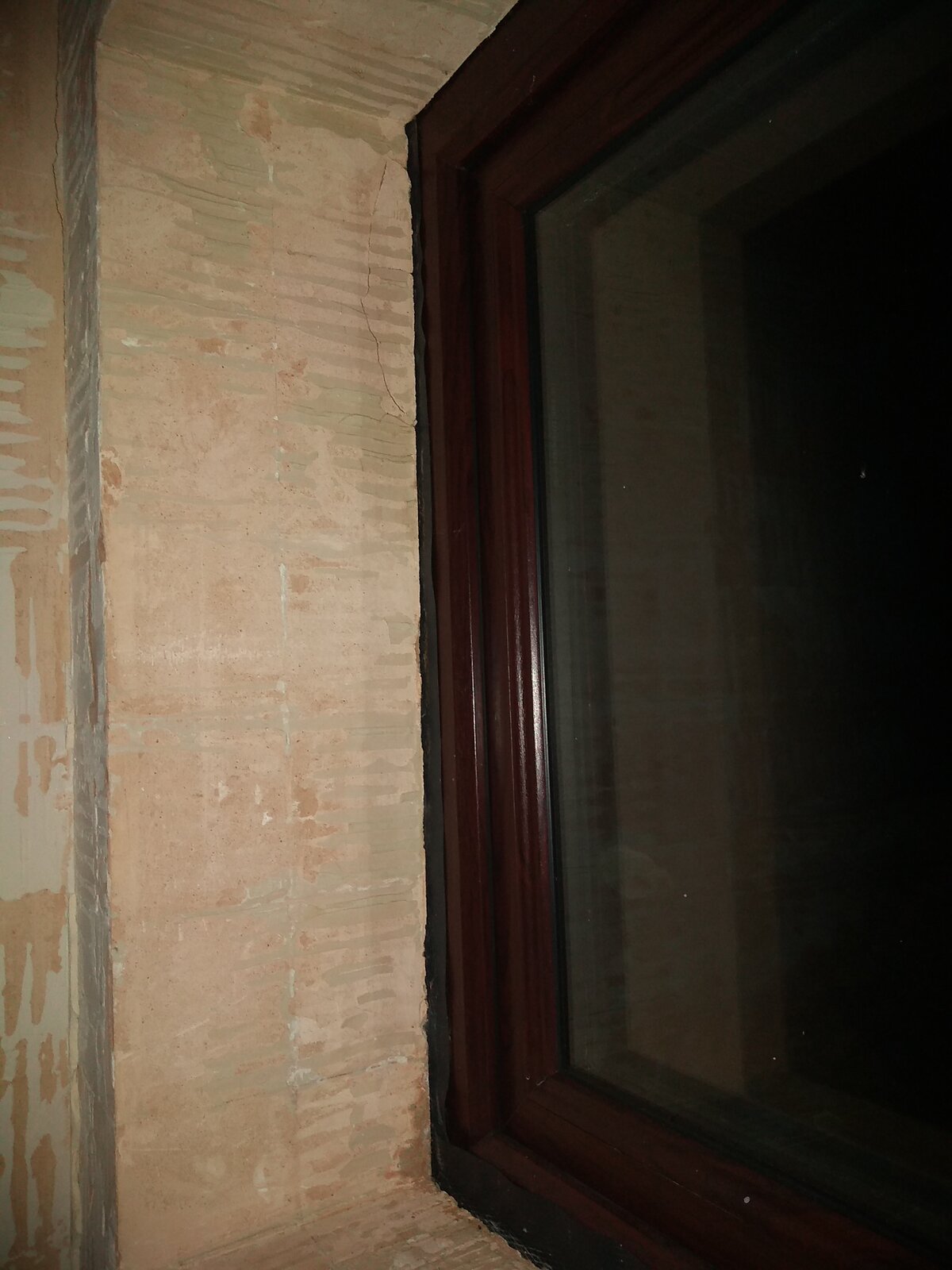

Slightly off topic, but before tiling I'll fill the small gap between the window frame and recess, which is around 5mm or so. Someone suggested expanding foam, but I didn't think it would be used on such a small gap? Mind you, I don't know a great deal about it. So thought I'd check here whether expanding foam or caulk/frame sealant would be best.
Also, you can see that black stuff sticking out. Is that some kind of damp membrane? Presumably I cut that back to flush with the window (or a little proud to allow for the tiles). But when filling the gap, should the black stuff be against the frame or the wall? I presume the frame but thought best to check.

silicon seals gaps
foam seals gaps and gives a bit off fixing and insulates but need a finnish
in other words should never be the surface layer or visible
Nice one, thanks. I used some frame fixings in the end, and will give the low expanding foam a go over the weekend.
Anyone got any thoughts on this before I do it?
Cheers
Mask it up to protect plastic and use foam. Foam sticks to upvc instantly so cover.
Few blasts of that and a few hours and all good. Window silicone around. Feet up
