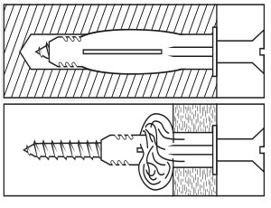

What type of screws do you suggest I buy for fixing a coat rack to a hollow door, 34mm thick? It's just made from cheap hardboard, I think. I bought these https://www.amazon.co.uk/gp/product/B009HN8J3G/ref=ppx_yo_dt_b_asin_title_o01_s00?ie=UTF8&psc=1, but think I was sent the wrong product (or at least I'm misunderstanding something, as the length of the bodies of the screw is about 40mm, so they're completely useless for my purpose).

The cavity fixings that you purchased are for plasterboard walls. I often use them but they won't work in your case because the "teeth" will not dig in and they will be prone to spinning as you try to tighten the screw. Additionally, the hard board will not be thick enough. Personally, I use the setting tool when using them. It pulls the screw forward and forces the "arms" to splay outwards.
https://www.screwfix.com/p/rawlplug-heavy-duty-setting-tool/8499g
There are nylon plugs that will pull along the thread and bulge out when it eventually meets the inner face of the hard board. Tox make ones that I have used with hardboard doors in the past but you can't buy them in the UK any more.
You could use traditional spring toggles but as you are aware, when you remove the screw, the toggle will fall into the cavity. That said, you could always buy a few toggles for the odd occasion that you need to remove the coat rack.
There are "newer" generations of toggles that can be reused but the hardboard will be too thin.
The plasplugs are not working. The weight of the clothes pulls them out so that the hanger sits at an angle of about 20 degrees from vertical. I'd better try some spring toggles. Only problem is they all seem to be at least 50mm long and my door is just 34mm wide. I suppose I can just saw the screws shorter.

If you are trying to hang a lot of weight on a hollow core door it is probably best to use a wooden pattress glued and pinned to the face of the door to give you more area to attach to the door. A single hook simply won't hold. Where the pattress is going on the door will need to be scraped back to the "wood" as glue onto a painted or lacquered surface will not hold long. If you use something like 18mm softwood or even 18mm MDF (with nice bevelled edges) you should be able to fix a hook or hooks to the pattress
