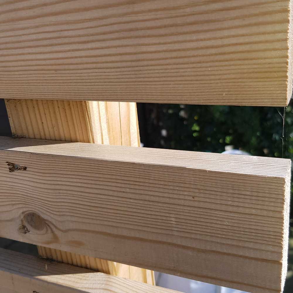

Building a 16.5m long trellis to sit 90cm above a 1m brick wall. Spaced at 1.8m the 1.8m x70mm square posts will be fixed to the wall and the trellis will be fixed to the upper 90cm of the posts leaving the lower wall exposed. The trellis is made of planed , pressure treated square edge 20x45mm battens. There will be a vertical batten fixed to the horizontals 1/2 way between the vertical posts to reduce flexing. I'd like as little head as possible showing on the battens. Which screws should I be using for the batten to batten and which for batten to post ? How should the 70mm posts be fixed to the wall?

the battons in you 'fence' picture look a lot bigger than 20*45 ?
