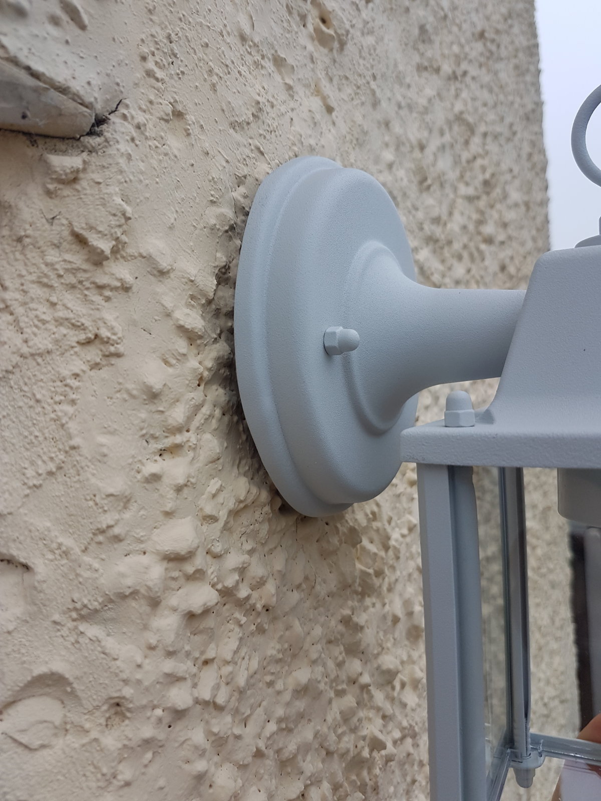

I'm mounting these lights from B&Q, and as you can see from the picture, there will be a gap between them and the wall due to texture.
What would be the best product to fill this gap?
Wire will be entering from the bottom of the light we it meets the wall, NOT through the wall.
The plastic backplate should have a rubber seal around the edge. The lights themselves do not need to be sealed to the wall.
agreed...i bought one and it came with a wall sealing washer..it sealed pretty well on the roughcast wall and i havent had any trouble

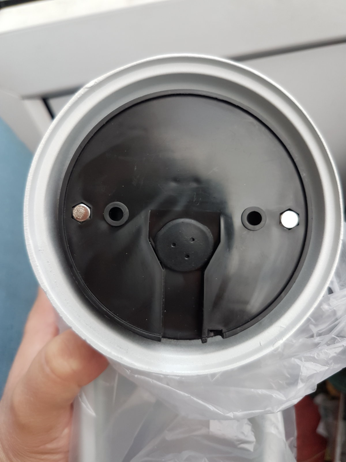

Oh! No, the only rubber seal these have is at the cable entry point.

yours is just begging for an 'O' ring to go in that annular groove??
you could fill that with silicone first then fix the fitting to the wall
as a precaution i would leave a gap at the bottom for any 'leaks' to drain off

Nope, Jon ;)
And yes, planning to leave a drain gap. Just trying to blend it to the wall as best as possible.
