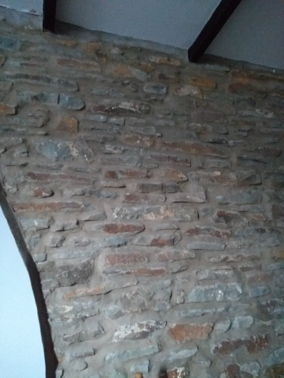

How do I seal bricks/concrete to a matt matt finish? It currently leaves a lot of dust. Thank you.

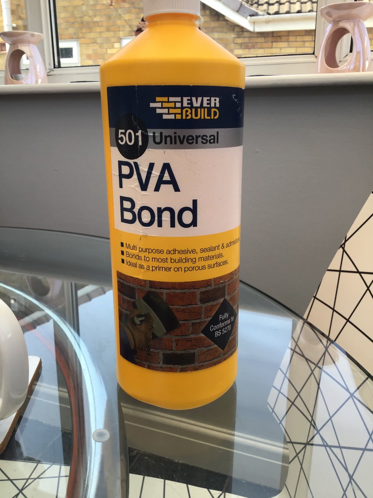

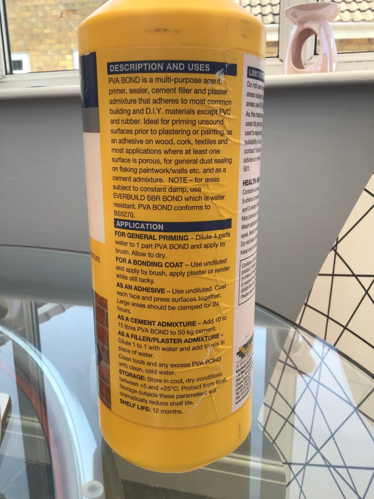

Pvabond will seal it nicely.
