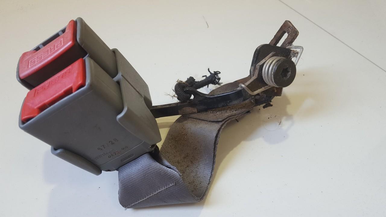

I'm struggling to see how you managed to attach the new buckle to the seat, though? Did you unbolt the pre-tensioner assembly and just bolt it on to the bracket on the seat that the pre-tensioner assembly used to attach to?

The child seat is going onto the back seat (where there are no pre-tensioners) so the only thing I removed was the original buckle assembly. This assembly consisted only of a buckle mounted onto a piece of angled steel which was then bolted to the body of the car. Once removed, I simply replaced it with the new buckle which emerges slightly higher out of the car seat.
I've attached a picture of the same assembly I removed. The spring pushes the buckles into an upright position when the seat is folded flat, but when you lift the seat up an elastic band (which you can see cut off in this picture) pulls the buckles flat so you can fold the rear seats over them.
Ah! OK, I misunderstood. I thought that was your solution for when it was in the FRONT seat. Yes, if the buckle is compatible with the Peugeot tongue, you should be fine with what you have. Just be careful that when a "human" sits in that seating position, the longer wire on the buckle doesn't come round the corner of their pelvis and/or leave the buckle assembly in contact with the abdomen of the wearer. You really don't want anything "hard" feeding the loads into the wearer, only webbing.
