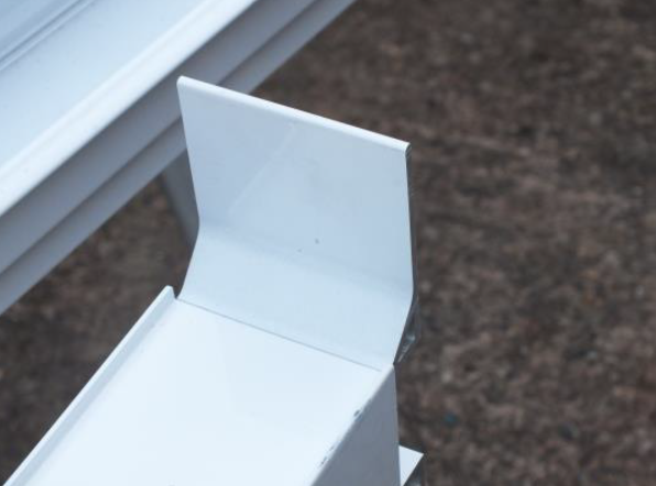

Hi Guys,
I am aiming to erect an aluminium / poly-carbonate carport on the side of my property covering 3 meters of my driveway immediately in front of my garage.
This is the style of canopy
There is a small dwarf wall of 700mm high and 225mm deep extending along the driveway and due to the narrow drive I will be securing the canopy legs on-top of this.
The canopy ideally requires the legs to be placed in a hole and concrete filled but this is not possible in my situation due to drive limited width (2288mm).
Can anyone suggest some methods to secure the supporting legs to the top of the wall? These feet come with the canopy but I imagine something more sturdy will be needed.
I was thinking of a fence post base like below and anchor bolts?

my thoughts but not an expert
try pushing the top off the wall with the sole off your foot to see if the wall feels solid and likely to fail
if not iff the hammer/sds drill do not dislodge any bricks you may be ok with bolt down metposts
What bolts do the manufacturer recommend. I'm wondering what the purpose of fixing it is... So that you can lean on it as you smoke a woodbine, or to secure it against upward suction, similar to a wall plate tie-down strap where you're attempting to mobilise more masonry than the force of the ip suction?
If the wall is sound. 300mm or so threaded rod and resin. All stainless steel. Don't just fix into a brick on edge.
Or have something fabricated that runs up the side of the wall then over the top into something similar to one of those post shoes.
That sounds like a good idea thank you.
So my next question is do you recommend a resin to use and sounds daft but what is the best method for drilling straight down so that the rods don't end up coming at all sorts of angles? I have a hammer drill but no guides or anything. Wondered if there was any tricks to it.
Any resin should be ok. Squeeze the first bit out as that tends not to be mixed properly.
It won't matter too much about the angle as you are only connecting to the thread close to the surface. But if you can't get anywhere near vertical, stand a brick on end with the corner close to the position of the hole. Or a can or tin or similar.
Galvanised rod will be fine if stainless is not available or too expensive. Just coat any cut edge.
