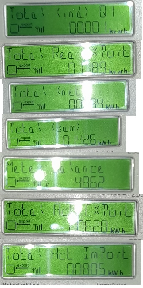

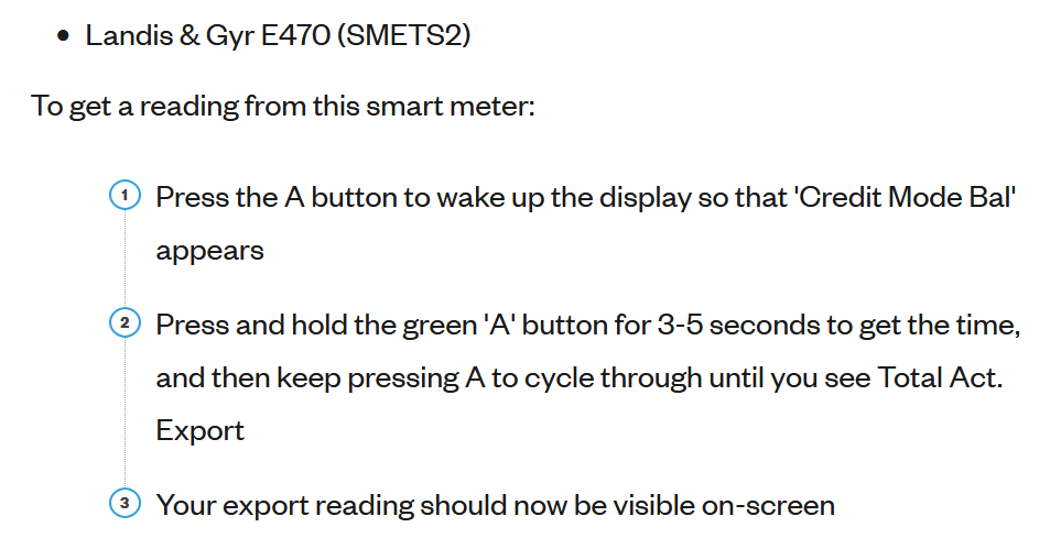

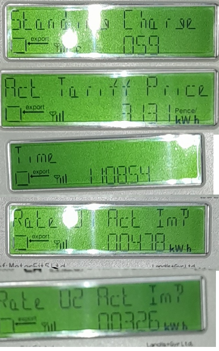

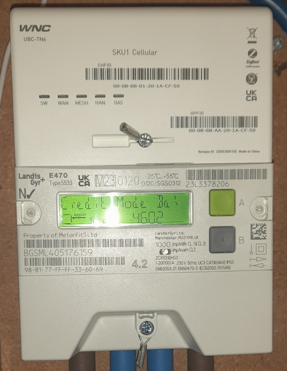

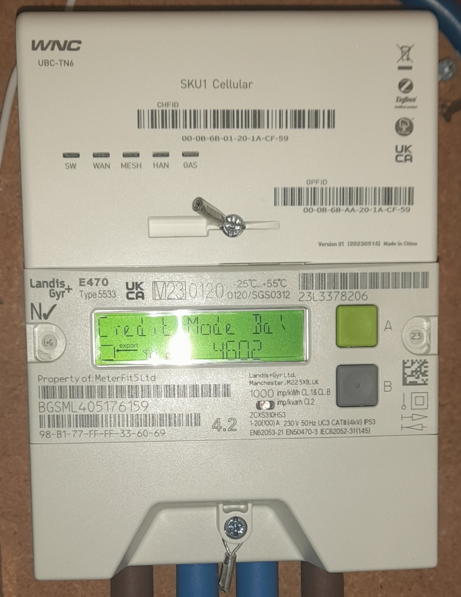

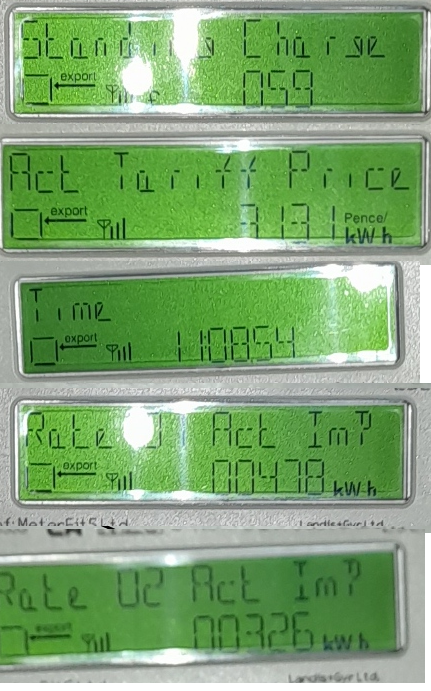

1715248075525.png The meter shows 4602 and from my app it would seem that is 460.2 kWh although can't see any point, however I would have expected at least three readings, import peak, import off peak, and export. I have tried pressing button B and got no money back, one screen says Boost? another everything X'ed out. Hunting armed with make and model I get 1715250170817.png so returned and tried holding the A button, to start with nothing new, then found 1715251036959.png which does give some idea as to what is going on. And further got 1715251895155.png which has left me wondering what is what, is what, the estimated reading of 05 Mar 2024 of 414.6 does make me think meter is missing decimal point, but scratching my head to work out what is what.
