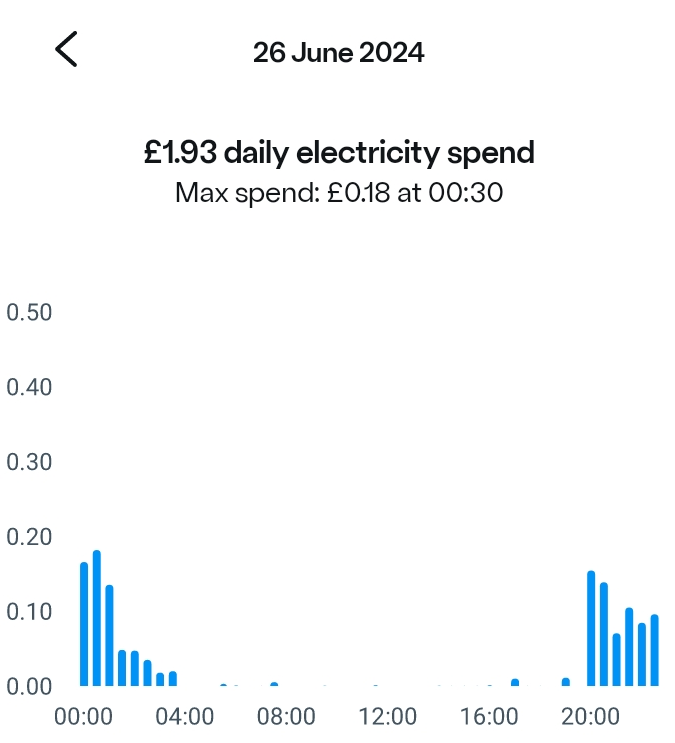

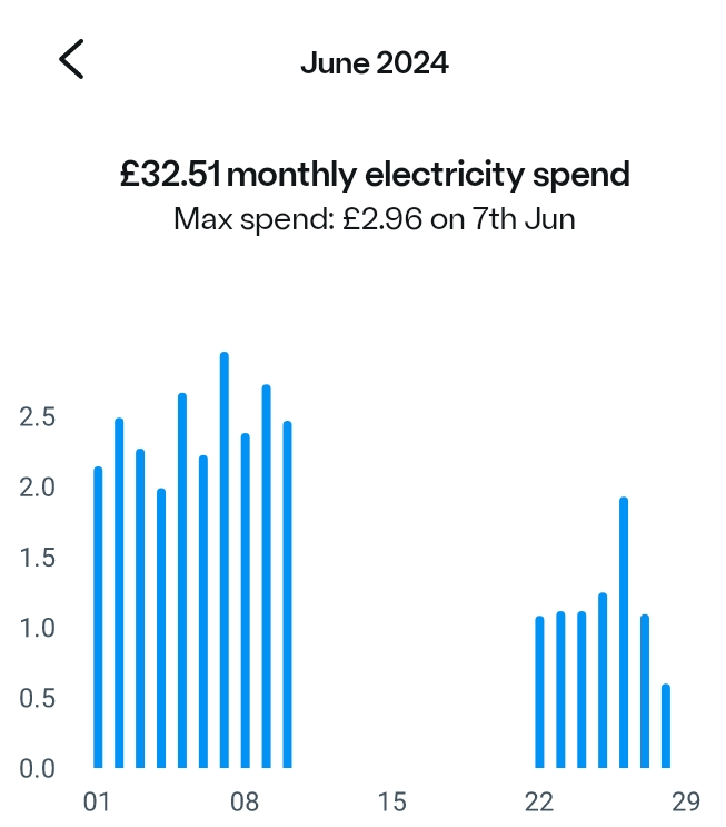

As to so-called smart meter, the info to my phone, is two days old, at long last getting cost, seems 23 June 2024 I spent £1.12 which raises the question is it worth doing anything to save electric. But be it British Gas app, or the luxpowertec app, the latter for the solar, it requires manual reading and for some person to use the info to manually start or stop some process. Seems no option to automate, in other words the electric meters are rather dumb. Both DNO one and solar ones, to get my DHW to heat when there is spare solar, it has its own independent wireless CT coil to tell the immersion heater controller how much to use.

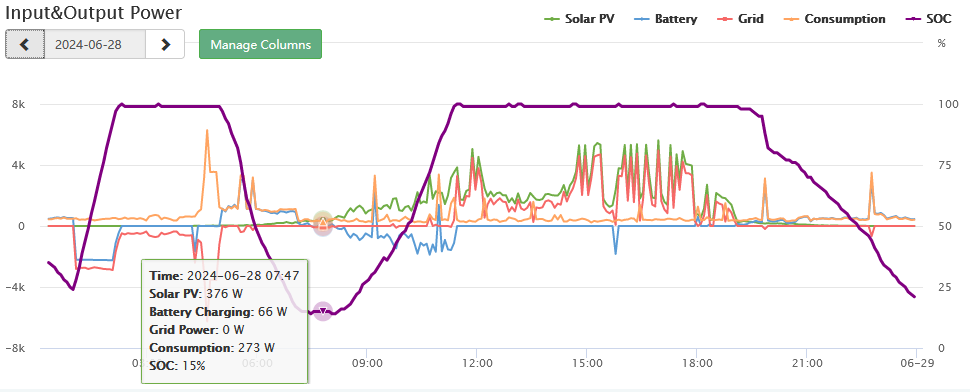

I only have a 3.2 kWh battery, this time of year that is enough to ensure still 10% left at 1 am when battery set to recharge, Also I often stop importing at 5 am and likely I could stop earlier and still the solar in morning will take over before I hit again the 10% this 1719619084095.pngfrom yesterday shows the three dips in the battery state, one before 1 am, one around 7:30 am, and finally one at end of day, my wife had dishwasher, washing machine and tumble dryer on during the off-peak, and the tumble dryer had not completed when off-peak finished, So it was running off the battery until the solar took over. And solar production was not that high anyway.Go back to day before, 1719619488228.pngand the morning dip was far less, and this is the problem with off-peak and solar, instead of it making life better, we become slaves to the sun and off-peak times, I suppose we become sun worshippers, watching the weather like a sailor!

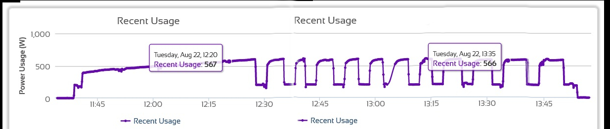

The power meter only shows an hour so this is stitched, and shows typical drying cycle of the heat pump dryer, as said some times it does a mark/space ration
typically with a small load, this shows the power used to turn the drum, around 200 watt, which although not high, when it uses only 600 watt to turn and dry, it is still a fair load in comparison. We are using 400 watt to dry, and 200 watt to tumble the load. The meter at moment is monitoring the freezer, so these are from last year.
