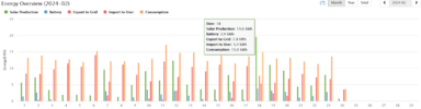

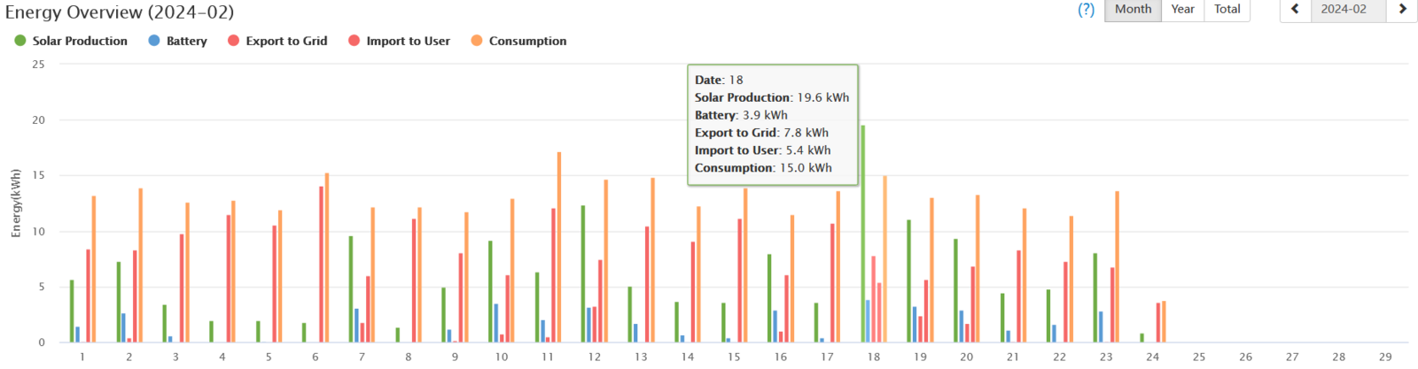

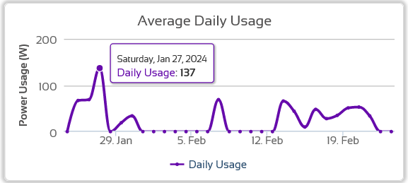

And in the evening we are hardly using much extra power which we could turn off, leaving lights on will not show up, plug in monitors may show how much the tumble drier is using 1708769731463.png and I can see looking at the solar panel monitor 1708769832113.png my wife selected a day with loads of solar power to do the washing. But that's using the solar panel software, nothing to do with smart meter or the smart meter monitor, we see all the adds, and as said before clapping hands will not turn lights on/off, need to say hey google turn the lights on/off to do that, the meter clearly has a use, it allows payment for export and multi tariffs, but the monitor, no wifi so will not connect to PC or phone, and it can hardly train people how to reduce energy use when for 90% of the time it is not showing any power use, or we are in bed sleeping.

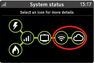

I some how thought it would be viewable on the PC or tablet, but since I have the solar software it does not matter, it seems the PC can connect to some versions of the monitor I have. No instructions came with it, but found them on line, and found where one is suppost to set it to connect to wifi but the options are missing. 1708826740715.png The bit circled just does not exist.

The example in the instructions, not had it on mine, so seems I was not Welcome! I did look but no
maybe because I don't have mains gas? It took me ages the find the instructions and seems most are for pay as you go customers.
